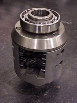

Quattros will always have less maintenance, easier to work on, and never has quattro had a TSB or recall issue with the Torsen differential since audi started using it in the 80's. It is literally "bullet proof" meaning it could actually take a bullet and it won't even ding the casing! I actually have a pic of a torsen that my buddy uploaded onto wikipidea when we were at the audi academy.
