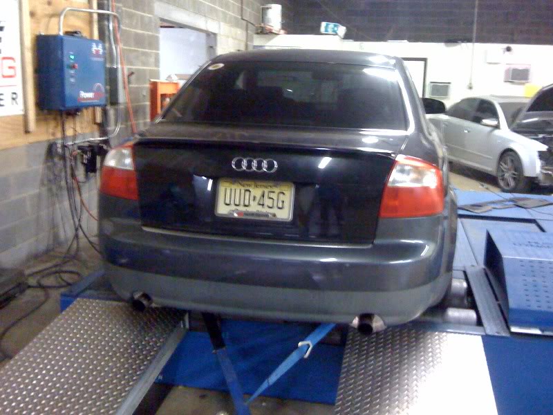

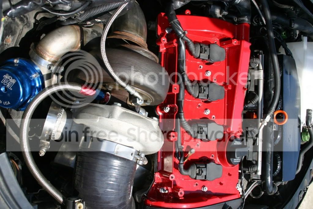

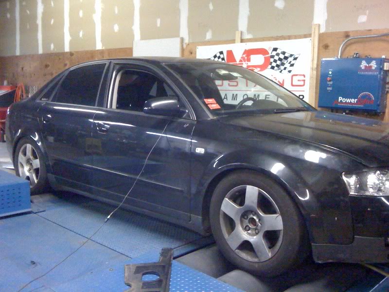

Guess I'll throw my car in here...
Shout out to R.A.I. for finishing the never ending project. They are just awesome, and awfully good looking
Block:
- Wiseco 9:1 83mm Pistons
- Scat Rods
- AEG Crank
- Southbend OFE SS Clutch
Head:
- AEB Head Stock Port
- Supertech Inconel Exhaust Valves
- Cat Gold Springs & Rosten Ti Retainers
- Cat 3652 Cams
- Stock Intake Valves
Turbo:
- Garrett GT35R .82
- Full-Race Longitudinal Manifold
- 3" V-band DP to twin 2.25" exits
- Tial 44mm WG (Open dump)
- RAI Motorsport Turbo Inlet Pipe
- RAI Motorsport Intake Manifold (huuuge plenum)
- Vibrant 875hp IC Core
- 2.5" Hotside, 3" Coldside Piping, V-bands throughout
Fueling:
- R.A.I. Fuel Pump in-line with stock in-tank
- Siemens 830cc Injectors
- Unitronic 830cc Tune (base file to drive on before the revision)

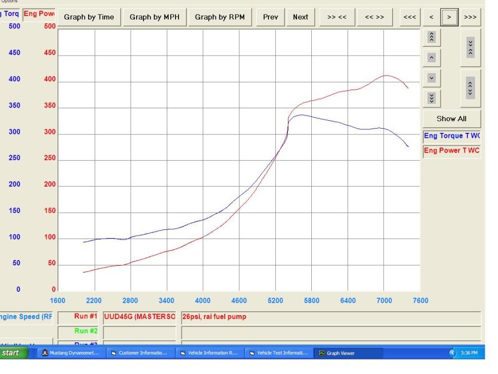

and the best run
- 437awhp, ~360wtq, (made 441awhp later)
- Mustang Dyno
- Pump 93 octane gas
- 26psi
[img][/img]
Stay tuned....
