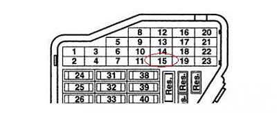

Originally Posted by z33_b6
Would I be able to trouble someone to try a quick test that would help me immensely? Basically, I am trying to figure out whether it's "normal" for the Climate Control Unit to illuminate when the fuse for the Instrument lights is pulled out. Would someone be so kind to test this out and let me know what you see? Thanks very much!!
its fuse 15 in the 02 1.8t I believe (in image)
Yes, my climate control unit do light up by pulling instrument cluster fuse (number 15). I think that's normal....my is also 02 A4 1.8t.
Try changing the cable it was the positive cable that they change, if u r doing it yourself it will be a cheap fix and I won't hurt to try.
Let me know what happen if u do change the cable, I would have do it myself if the car wasn't in their shop 35 miles away....
Just FYI I search all over the Internet to find solution and no correct answer, hope this help.
