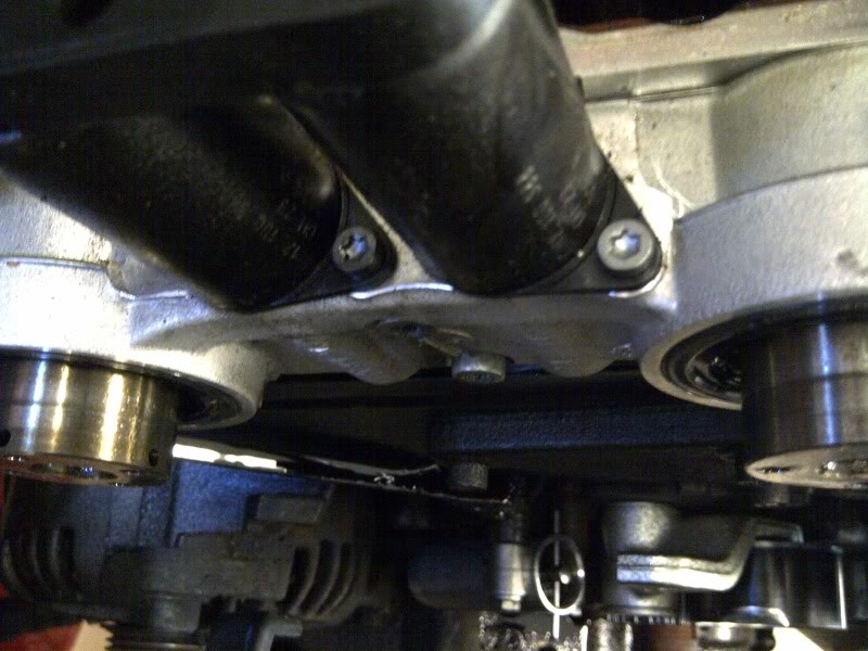

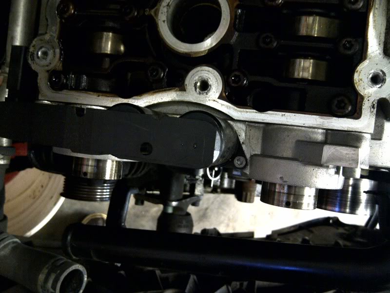

Hey guys,
I've decided to take on this project myself, and have gotten to the point of removing all four cam pulleys. I took off the belt, unbolted the cam sprocket bolts and this is what I'm looking at. I haven't picked up the new cam adjuster seals, which I'll be doing tonight, but I was wondering just what else I should or will be having to unbolt and take off. The timing belt write up only gets me so far as taking the timing belt off unfortunately, so I'm hoping I could get some info on what comes next.
Here are the pics of what I'm looking at after the cam pulleys have been taken off. I also took a picture of where a ton of oil seems to have accumulated right below the main crank sprocket. I know there was oil leaking from the valve cover gaskets since I found oil lining the length of the covers, and 3 coil packs were pretty well saturated with oil as well. Can the adjuster seals leak this much oil? And could it all end up in that general area below the main crank pulley?
Any help is greatly appreciated guys!
