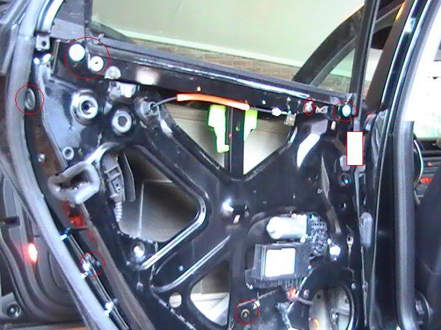

when you take off door panel you'll see this:
take off center plastic panel and motor, not hard but screws are soft so be careful

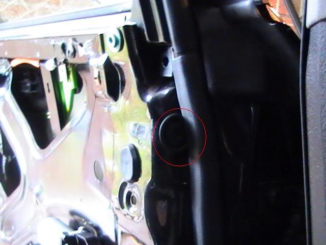

I circled red the screws that hold window frame inplace, if it doesnt start moving freely i may forgat one. i did it like a year ago i think. DO NOT REMOVE DOOR LOCK SCREWS unless you are 100% that lock is stoping frame from being removed. Once you pull it out CAREFULLY it should look like this

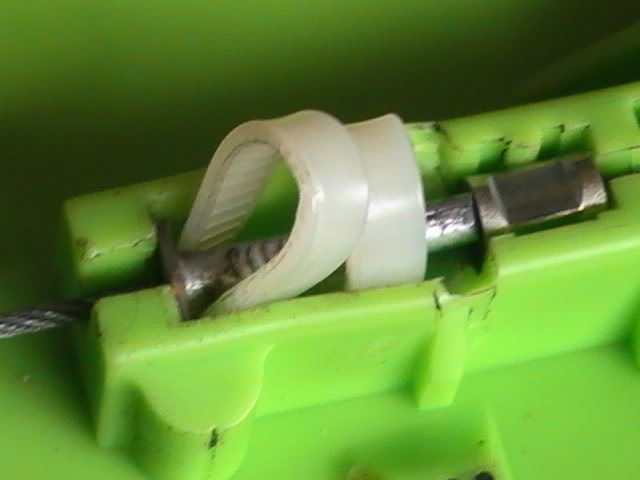

here is what broke on mine and how i fixed it
i got nail made a grove in it for cable and placed it like this securing with zipties
after that i filled it with EPOXY FOR PLASTIC on both sides and it worsk like a champ.
