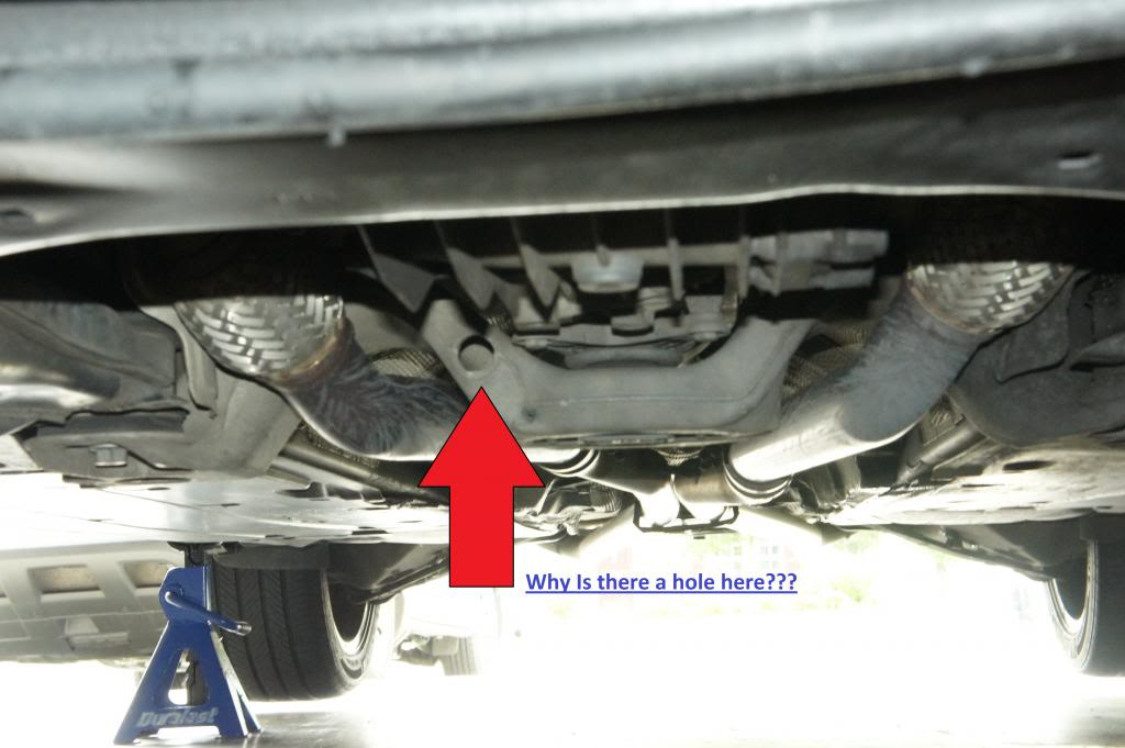

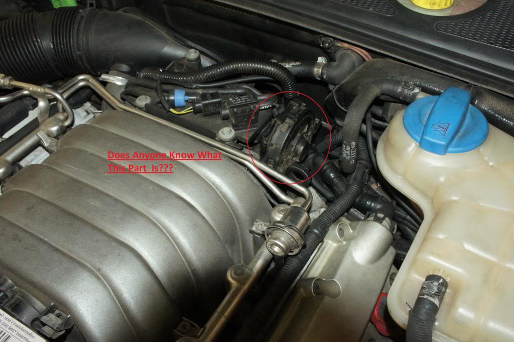

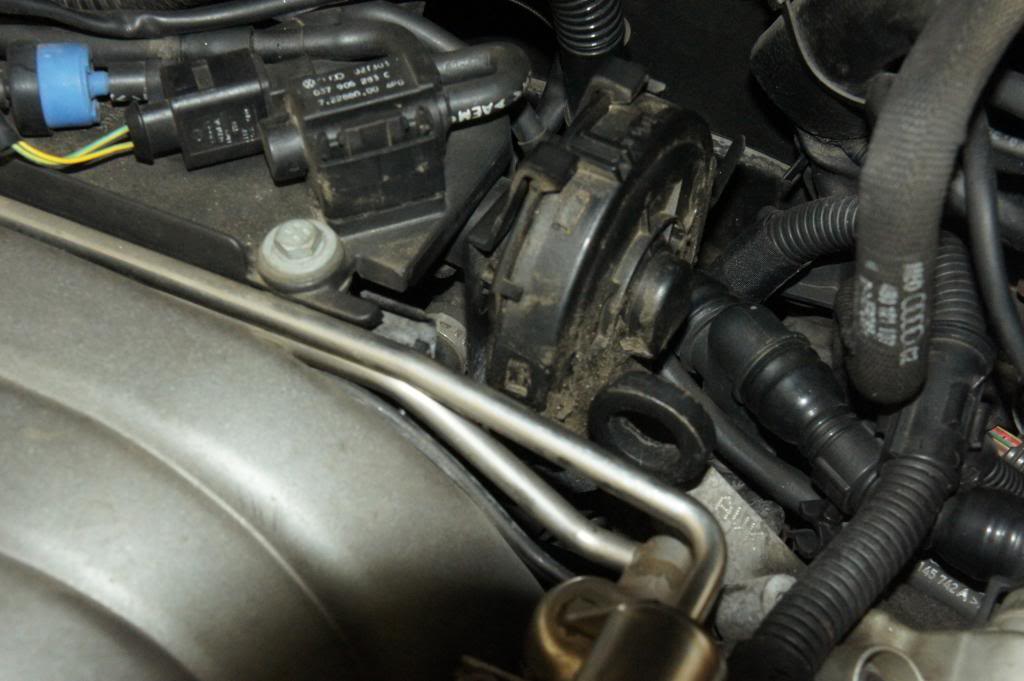

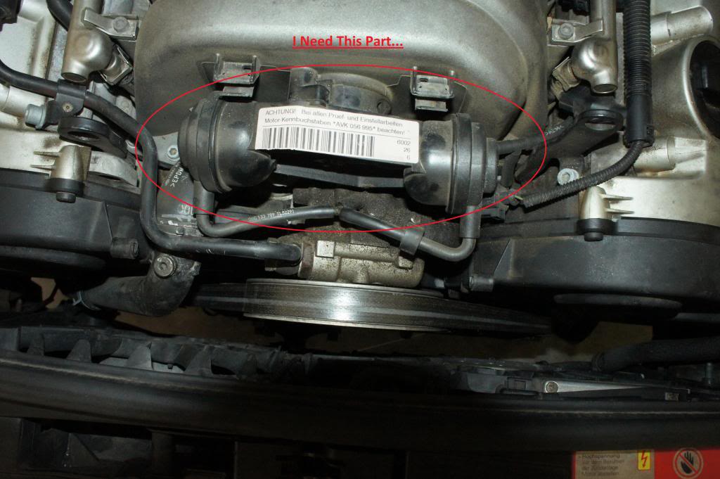

Morning,
I am attempting to get my '03 a4 3.0l (b6) repaired and am needing advice. to start, she is failing emissions and in that issue i'm unsure as to where to start. Then comes the more recent issue in which she (olivia the a4) is running really, REALLY rough... the engine shakes when idling or driving. I believe this issue to be tranny/flywheel related as the car is fine to change gears when off or standing still but damn near impossible to do so once the vehicle is moving at ANY speed. lastly, below are some pics that while diagnosing the car i took and had questions on. Please don't be shy, any advice or input would be grateful.
Again, any input would be appreciated as i need her back on the road and have no other wheels right now.

I had the emission prob before. Long story short...I bought this car end of April for my birthday, I knew it had high miles but the guy assured me that she ran strong (silly me) and when I test drove it there were no issues. After buying the car I found out I couldn't pass emissions for state inspec. So I was going back and fro getting it checked and know now the emission prob is based on the piston for the intake actuator being broken, hence off pattern. Easy BUT expensive fix.

i really dont think the intake actuator would cause you to fail a emissions test.. they're really only there to keep you within the power band for a longer period of time..
