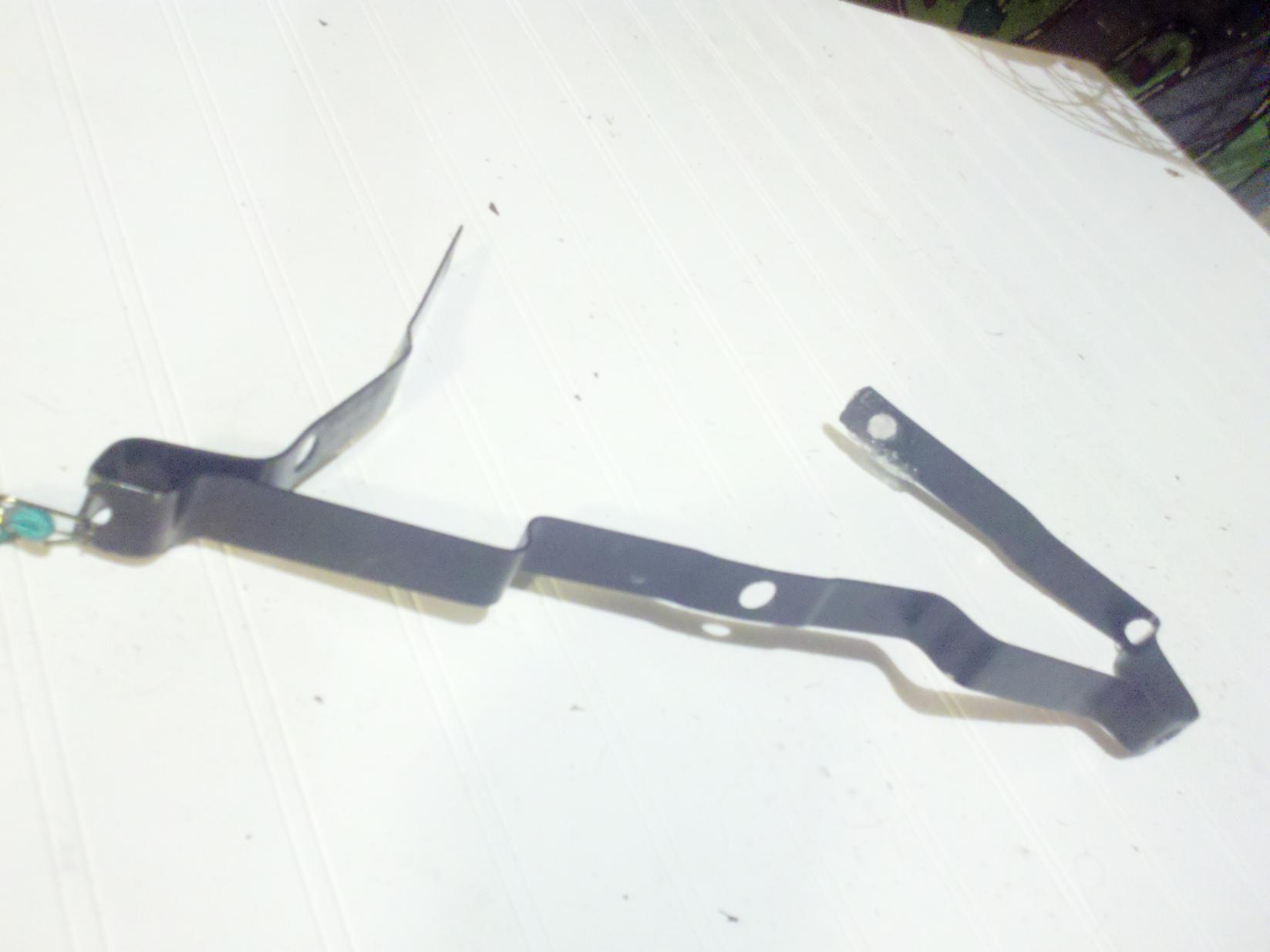

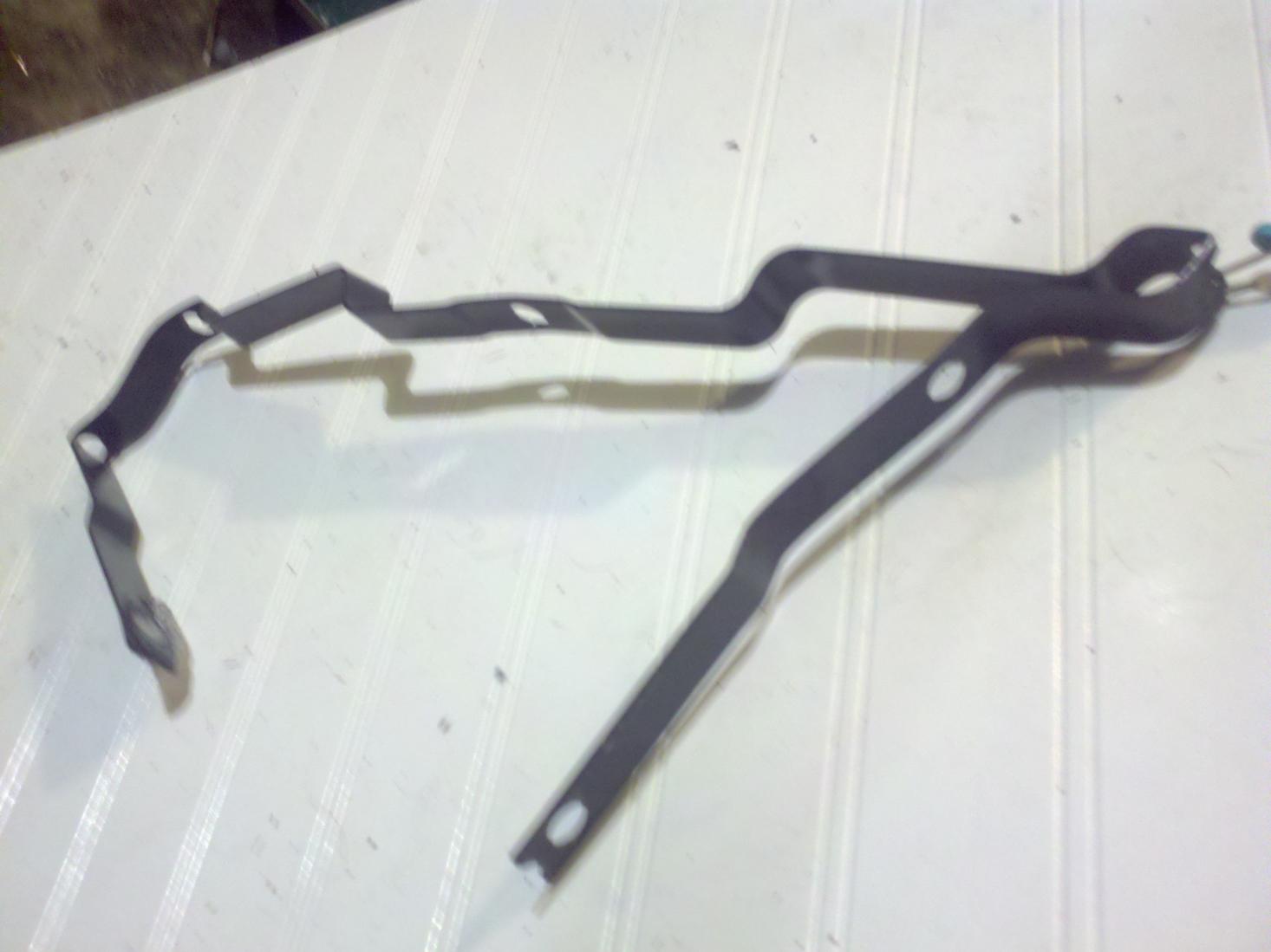

Got hung up in a snow bank last night. Got it pushed out okay. Started to go to work and heard a scraping noise from under the car. Looked under and found a bracket hanging down. It was connect by one last 10mm screw and was up by the linkage for the steering(?). Does anyone know what it is, what it's for, and do I need to get it back on quick???
Thank you in advance,
Dennis

Its the bracket to hold the rear of the plastic belly pan in place. Since that piece is mangled under the car im gonna go ahead and guess you don't have a belly pan LOL.
You can get a new pan and bracket on the link, scroll down the page halfway. http://www.ecstuning.com/Audi-B6_A4-...ody/Belly_Pan/

Thank you for your response. Looked under and sure enough, no belly pan. Oh, and thanks for the link, also. LOL, Never would have guessed what it was.
