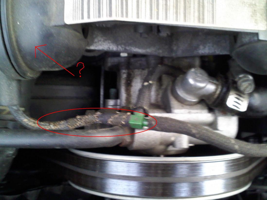

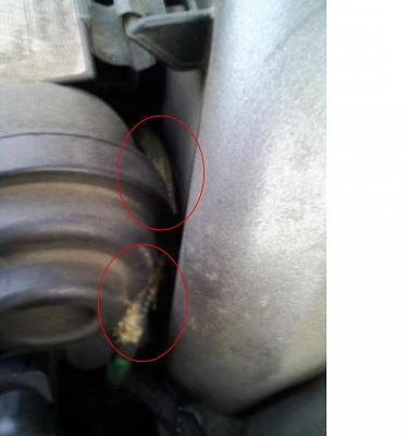

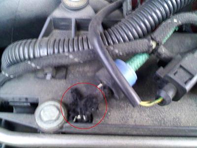

3rd ? - I opened the hood and found what appeared to be braided vac lines that are really worn out (see pics), I have some silicon hose that I used to replace the vac lines in my b5 1.8t, are these lines the same size?
4th ? - the lines run into what appeasr to be a valve (see ? in pic), there are two of them, maybe a noob question, but what are they for?

vac lines on B6 are braided and rot with time due to engine bay heat. replaced mine with 3.5mm silicone but can probably use 4mm. Replace yes, it affects performance. I would also replace any valves that are damaged.
