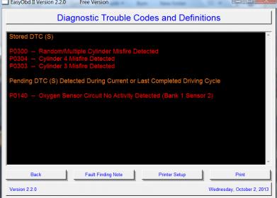

I possibly gave it a little too much gas in second, at a fairly low rpm - nothing ridiculous, but the engine bogged down, almost stalled, and immediately started running VERY rough, flashed the yellow check engine light, etc. SO, I babied it back home. It sure felt like I was down to 2 cylinders..! VERY rough and very little power, too.
I've got a generic OBD2 scanner. I'm not sure if a better scanner/software would give more precise info, but this is what I got:
Stored DTC (S)
P0300 Random/multiple cylinder misfire detected
P0304 cylinder 4 misfire detected
P0303 cylinder 3 misfire detected
Pending DTC (S) Detected During Current or Last Completed Driving Cycle
P0140 Oxygen Sensor Circuit No Activity Detected (Bank 1 Sensor 2)
Stored DTC (S)

The verdict? One bad ignition coil. I checked them all (and the plugs) and swapped them all around. The computer picked up the location of the bad coil more than once. Swapped it with a new one, and everything is happy again.
