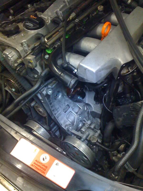

In this picture where you see the red G12 coolant. That is where the thermostat sits. If you see where the timing belt sticks out to the right directly on front of that... that is your Water pump. Stock the pumps came with plastic impellers that are known for going out. When/if you replace this make sure you order the one that comes with the metal impellers
