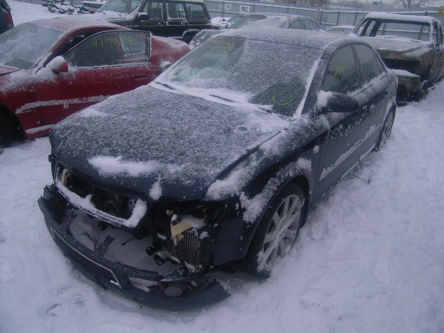

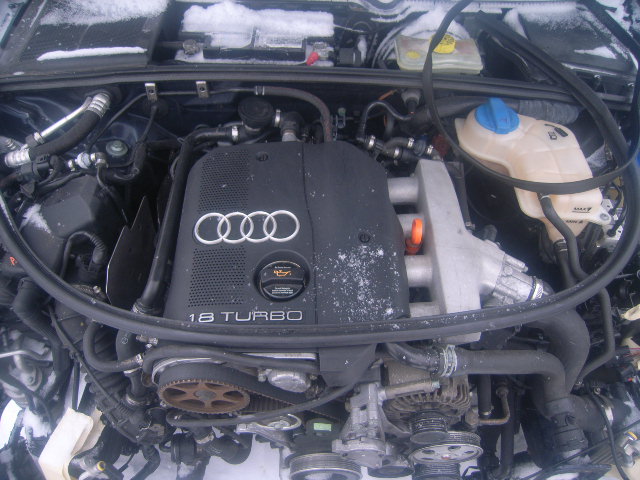

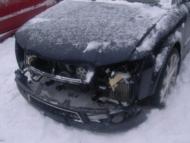

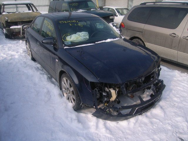

So I was looking into getting a 2005 1.8L A4 (B6 vs) 6speed. It is a salvage car. It has been in a front collision (look at attached pictures).
I was going to ask for your opinion (the public, experts) on what you thought on this route.
I have quite a bit of mechanical experience, and feel confident I could patch this baby up as I have torn apart an a4 v6 motor fully to do a head gasket job. But, what do you think? Would it be worth it if I got it for a good price?
Also, can anyone give me a better sense of parts I may need. I have a good idea, but not fully sure.
The pics are posted below again. Take a look and let me know what you think. The pics aren't the best, but they are from the site this car is being sold. This car is being auctioned off this next week....so your hast opinion is highly appreciated

Airbags are deployed, I'd say you'd have to live with a lot of light on the dashboard, the damage doesn't seem to be substantial, unless the pictures are not doing enough justice; and I also believe that's an Ultrasport version, so the damage could have been merely cosmetical but once again I don't know. Make sure the subframe underneath didn't break or become missaligned. Seems like you're going to need everything on the fron of the AC pulley (radiator+support+steering cooler+bumper absorber+bumper+lower airdam+underbelly pan+front grille, all of them+headlights+foglights+rebar+maybe even intercooler+perhaps some cooling piping).
I wouldn't buy it unless is under 4K.

What do you think about the airbags? I can't tell if the drivers side airbag went off, but the passenger side airbag definitely went off. Is it tough to replace the airbags? I understand with the passenger airbag, one might need to replace the whole dash. What else is there involved in replacing airbags? Are there side airbags for the B6 series? Also, what about seat belt airbag tensioners? The control module can be fixed up or replaced with a used one, which isn't a problem. I had to do that to my current Audi. But I'm not too familiar with handling airbags. If anyone wants to give some input, that would be great!
