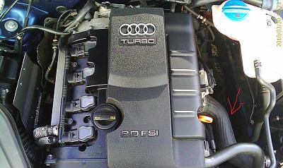

im thinkin i could just get a local pipe company to custom make one. just take off the factory rubber one and have them mandrel bend one to fit
here is a pic of the piece im talkin about

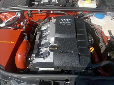

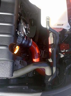

yeah i put a custom one in mine...
Attached Thumbnails air intake ideas-2010-03-18-14.24.20.jpg   air intake ideas-2010-03-18-14.23.01.jpg

wow that looks really cool.
is that steel or aluminum?
what kind of air intake/filter do you have?

Those are basically the intercooler charge pipes, it won't be under the intake when you search. You can just do a useful upgrade and install an FMIC which WILL give you a power increase, plus its ****.
http://www.atpturbo.com/mm5/merchant...ory_Code=VVWIK

to be honest, it probably wasnt a great idea. yeah it makes a swoosh sound, but before i was getting about 13psi (stock intake) and now its only about 10psi. The throttle response is a little better though. it is aluminum and its an AEM short ram intake.
if i had it to do over i probably would have spent the money differently, just b/c of the loss of boost.
btw... anyone have any suggestions on how to get the boost back? Quick fix?

Get your boost back? Putting in a bigger turbo or changing back your old intake will regain your boost. You made the intake pipes bigger than they used to be and you put a higher CFM filter on it. That would only benefit you with a larger turbo that can push the air. The same thing happens when people get a large core intercooler, if the turbo is too small for the amount of size piping your using, you will lose PSI.
Yes you gained throttle response, but if you dyno'ed it you would probably see a loss in horsepower.
