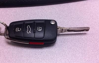

Default Key picture in Manual
I have the same problem with my second key. But my manual does not help me - I have a 2005.5 and my keys do not look like the picture in my 2005 manual. Several small schematics in the manual differ from my car and I think the manual is probably for the B6.
Does anyone know how to disassemble (or link?) my key shown below? TIA.
That's the same key I've got for my '08 B7 so linking should be the same way as mentioned above. I'll try and upload a photo on how to disassemble and replace the battery.

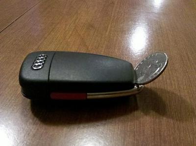

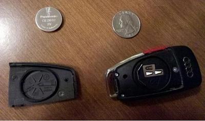

Default Key Fob Battery Replacement
Took pictures of the process for replacing the battery on the key fob.
All you need is a coin to pry off the cover.
The battery size is 3V - 2032
HOPEFULLY this will help you if re-syncing it doesn't.
Let me know if you need any thing else...

Default Key fob Opening proceedure
So before any1 breaks the latch on their key fob. take NOTE: in order to properly open the Fob flip the key open first with the Button. under the key is a press latch for a small flat head screw driver (not mandatory item to use). then you use the screw driver to pry at the bottom of the backplate of the key where the loop for the key ring is as shown in previous comment about using the coin to open. Hope this helps any1 who hasn't already busted the plastic latch on the fob. I currently have the same problem with my 07 S line and will try the reset method i read above. thanks!
