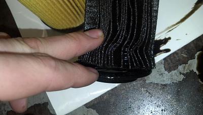

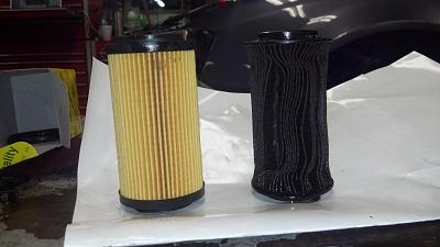

I'll start with the story then ask the question. I have an 07 a4 Avant with the 2.0T. Normally I have the car serviced at the only place I trust down state (Michigan). Long story short I changed the oil and used a NAPA Gold filter instead of waiting. 4000 miles into that oil change my oil pressure light comes on (spring time, car warmed up and cruise set). By the time I could get off on the shoulder it was too late (the motor was knocking). I called my shop and he already new what the problem was, sure enough I had it towed there. They checked and the oil filter cartridge looked like a crushed beer can.
They said they see a lot of that in the "cheaper filters". Has anyone here heard of this potential problem? The findings by NAPA/WIX said it was a problem with the car and not the filter. I guess at a minimum at least it's a heads up. With the price of a new long block I will never make that mistake again.
Any knowledge in this area would be appreciated.
I have only seen that once before. A better mechanic then me told me that when the oil pump ran out of oil it started to suck air causing the filter to collaspe some. I think that might be what happened here as well.
I suppose it's possible, but with cruise set on a flat highway and oil level at the full mark I'm just looking to check out all the possibilities. After paying a little over $9000 for a new long block to be installed I just want to try and remove any possible external weak areas.... Love the car too much.

How did your engine fail?
Hopefully your mechanic can provide a better answer than blaming the filter.
What is the actual hypothesis for how it caused the engine to fail? Did they drop the pan and open the top before replacing the engine? What if the chain driving the oil pump and balance assembly failed? You said the engine was knocking. Do you mean like ignition knocking? Rod knocking? Engines that fail usually have oil filters jammed full of metal shards. If unfiltered oil killed your engine, the aftermath would be all over that filter. It's not.
Did you start the engine again afterwords? The intake cam timing is adjusted with oil pressure. When you turn off the vehicle it locks into the position needed for starting. Once you start it up it's supposed to pop out of that above 10 PSI ish of oil pressure. If you've got an oil pressure problem, you sometimes see those errors pop up first.
I'm sure there were plenty of stored codes along with whatever was going on. If I was you I would have wanted to get a good look inside that engine!
