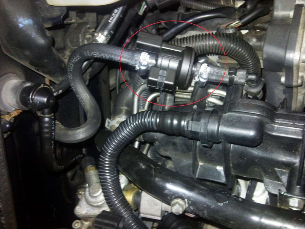

Played hookie from work yesterday. Picked up a new N80 valve plus clips for $21 at dealership. Going to replace it this weekend. A lot of articles I read state that the N80 valve should probably be a regular maintanance item. With my car having a bit more than 75k miles on it, I figured it's probably a good idea to replace this. It's a cheap item, and can be replaced in about 20 minutes with a pair of pliers.

^ Which one is that again? I have heard so many people mix references between the DV, N80, 710N and a number of other things that I've lost track of what the hell is what, and what it does for that matter lol. I know for certain what the DV is, does, looks like and where it is on my car; can you post up a pic of which one the N80 is, and enlighten me on what it does maybe? I think someone once said it was part of the internal wastegate once, but like I said, a lot of people seem to mix and match the names of various valves so I have no idea haha

audizine.com replaced-the-n80-valve-no-CEL-smoother-idle-no-vibrations-when-in-D
Check it out, with pictures!

Point 1: you should consider editing your link above. You seem to have missed a colon after the http in the url so the link doesn't take you anywhere. I found it by right clicking your link, clicking to copy link location, pasting that in the address bar, and seeing that it was missing the colon; inserted that and it took me to the page
Point 2: This isn't what I thought it was, but good info regardless; I think I may consider swapping that out to see if it takes care of some of the noise in the engine bay. I gathered from the link that some of the pertinent ticking that is present in there could be caused by this. I know most of that noise is just the fact that its FSI, but mine seems to be a lot louder than expected so since its such a cheap part and easy to swap out, I think I'll go through with it, even though I have no codes or anything about it.
I haven't gotten to mine yet. Have the parts and clips ready to go, but never seem to have the time. I'm hoping to get it done this weekend, unless of course the wife decides I need to paint more in the Slanty Shanty.
