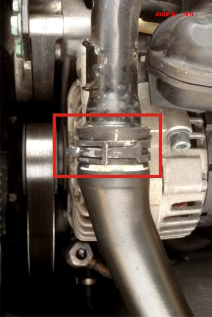

This is what I did: (caveat: I'm not an expert and this is my first time doing this without following any DIY)
I started working when the engine was really cold. I Removed the engine cover. Released tension from the serpentine belt using an open 17mm wrench pulling in the direction of the arrow in the photo below. This allowed me to slip off the serp belt from the the alternator pulley. I found no need to remove the serp belt all the way. I just made sure it cleared the alternator.
Next, I removed the upper radiator hose connected to the top of the engine. I removed the end nearest to the engine only.

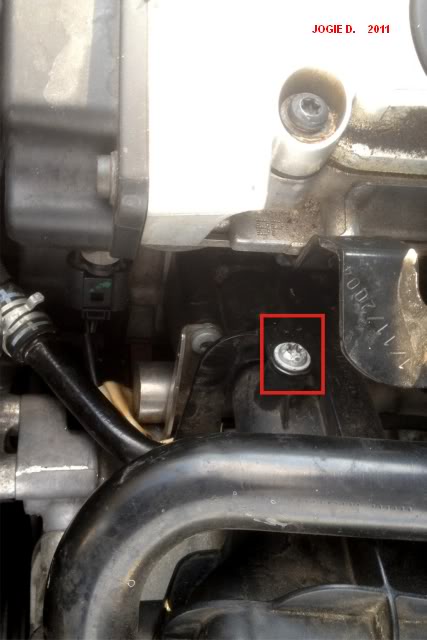

I removed this torx screw to make this metal hose/pipe moveable later (sorry I have no idea what it's called):

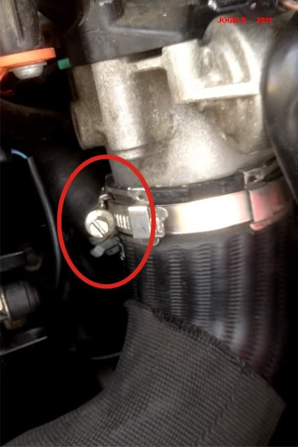

I also removed this big hose by turning on this screw head anti clockwise:

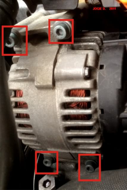

Next, I removed the alternator by removing this 4 hex bolts:

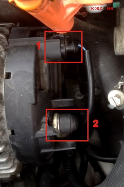

and then the 2 connectors at the back of the alternator (note no. 2 needed a socket wrench. This one is live with positive 12v current so I immediately covered the wire with electric tape after I took it off the alternator.)

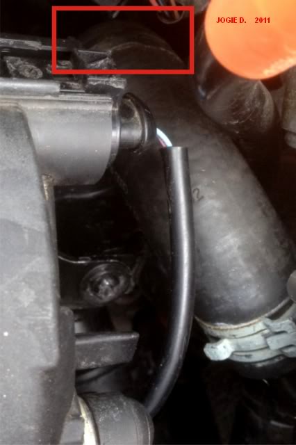

I started with the topmost hose which was connected by a clamp. This one was really hard to get out. I used a flat head screw driver to carefully pry it out of the thermostat.
note that the picture above was taken after everything was put back. You should be able to clearly see it once the alternator is out.

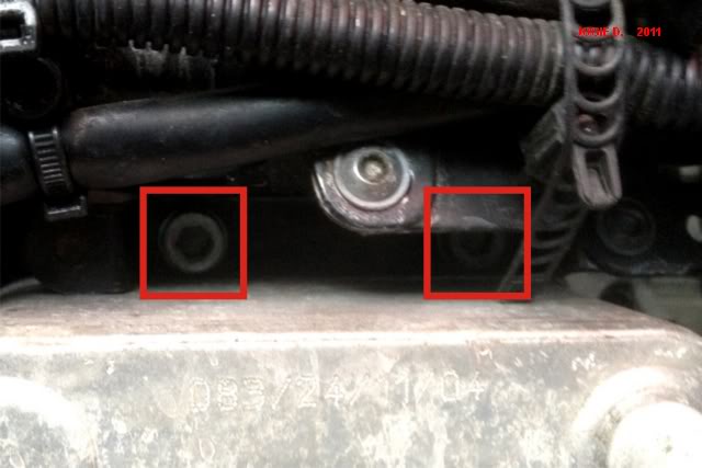

The center hose will not come out easily. It's metal and it won't flex. I had to remove 2 hidden hex bolts top of the oil cooler. These 2 are impossible to see unless you use a mirror.
I used the same allen wrench bit I used to remove the bolts on the alternator.
