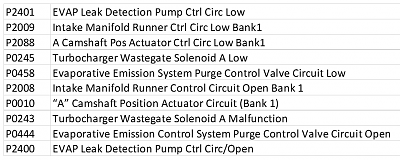

CEL suddenly on and throwing 10 codes that don't seem related. Any idea on what could be a common issue here? I cleared them once and they all came back immediately. I do not notice any drive-ability issues. Here they are:

Based on the codes I'd say you have a vacuum leak somewhere

Thanks - Yes it seems like it must be a problem common to all the codes. It's going to the shop next week so I'll see what they find and post the result.

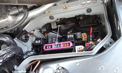

Turned out to be a blown fuse in the underhood tray by the ECU. I've attached a photo of the offending fuse. I took it in and the tech did a thorough look over. He had some concerns that it may be related to engine mounts but in the end just replaced the fuse. The car drove well for a few months then this past weekend the CEL came back on and the car is gutless.
The fuse was blown again so I replaced it and reset the codes.
The CEL has not come on again, but the car still has no power, like the turbo is not functioning.
Does anyone have a diagram of this fusebox? I can't find one online and would like to know what systems these are for. Any ideas on the problem of no power would be appreciated before I take it back to the dealer for a check.
