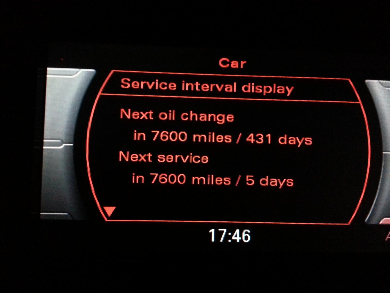

Hi
My 2008 Audi A4 (B8) 2.0 TDI (170 BHP) is indicating that the next service is due in 7600 miles/5 days. However when I view the Service interval display it states Next oil change in 7600 miles/431 days.
I have owned the car since August 2013. It was last serviced 17/01/2013 and had its timing belt and water pump changed 22/08/2013.
Can anyone help explain this discrepancy? I have added pics for illustration.
Thanks

There is oil reset done in mmi & there is service reset done with vag- com or 5052/5054 in the instrument cluster.

Thanks for the reply. Would you say that the 2 systems were not reset correctly at last service? Should the car need a service so soon?

I think the shop might not have realized. Took me a while to get it figured out.
