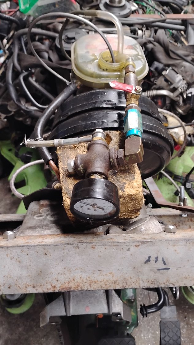

however what i have learn about clutch's in this time is hydraulics!! Master needs to be sized to flow enough with petal setup and slave's bore size. AND the aftermarket master come in different size bores weather for same part, exterior dimensions wise! while looking for masters i noticed some cylinders MAY NOT indicate bore size within part number, some are embossed with a bore size.
so id advise just get a matching master cut hole large enough, BUT leave enough material to "grab', to install cylinder while pedal cluster is in car and booster is in the way. then you can slip it in and a custom 'washer' with spacers to bring it to clearance and to back it up.

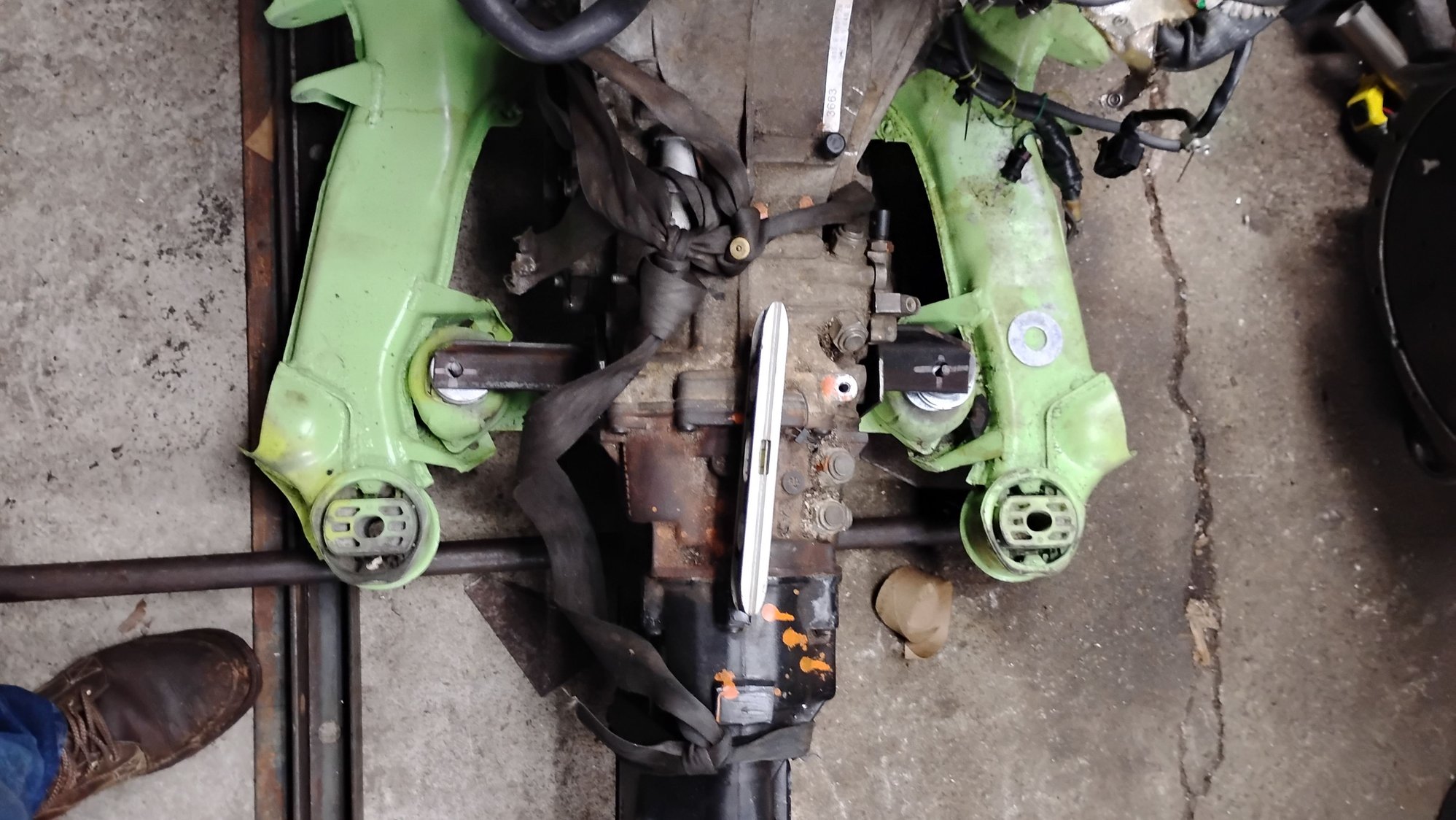

After all the transmission measuring I still get tripped up by the clutch. My slave still isn't disengaging the clutch. So to test outside the car.....
I found two different length stock plumbers. I measured assembled and found my setup needed half inch extension, just threw a bolt in there and it works!!
I found two different length stock plungers. I measured assembled and found my setup needed half inch extension, just threw a bolt in there and it works!!
Locked the front axles, put in gear, depressed clutch and you can free spin the rear🥰🥳🥳
Just views of clutch petal clusters, holes and spacers for the master cylinders that's I found.

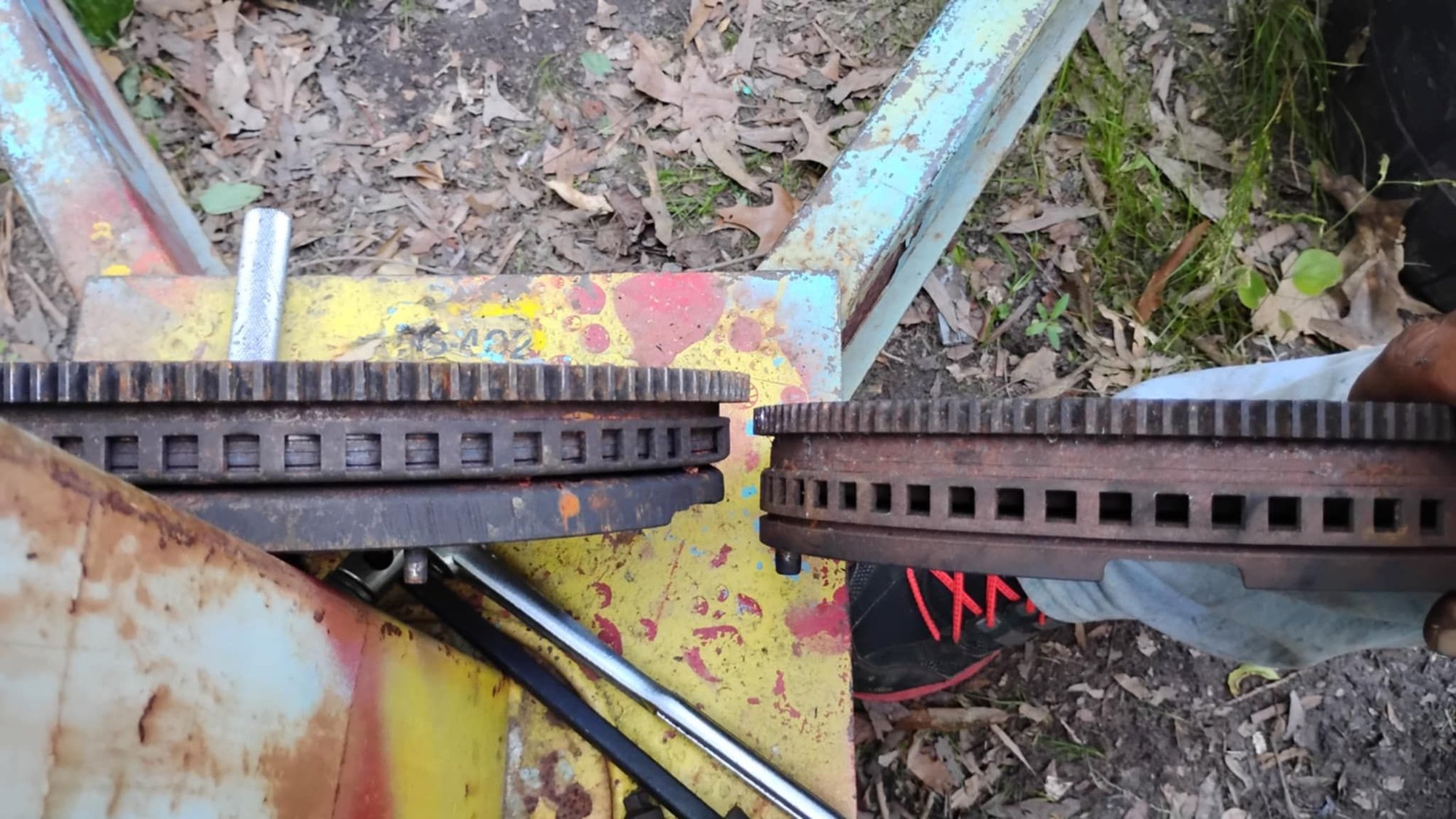

And found out wrong flywheel is why I had to modify starter. Flywheel I had was dual mass but tone ring was spaced wrong. There's a gap in between starter ring gear and tone ring space for starter nose to fit. Swapping in correct flywheel and putting clutch hydraulics in soon. i dont recall which car i pulled it from
