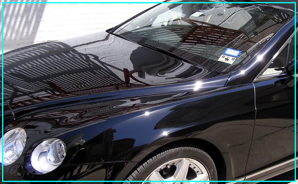

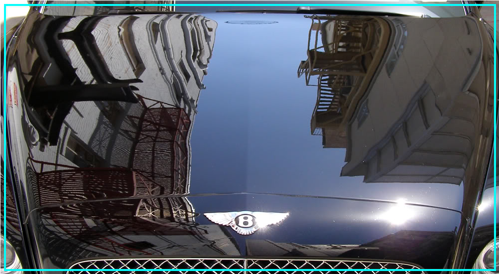

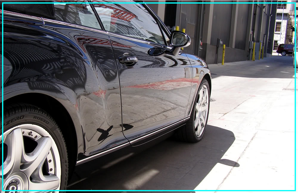

this was a 2 step correction
- flex da with meguiar`s polish pad and mezerna sip
- meguiar`s g110 da with hex polish pad and meguiar`s 205
- blackfire wet diamond sealant
Pictures before correction:
