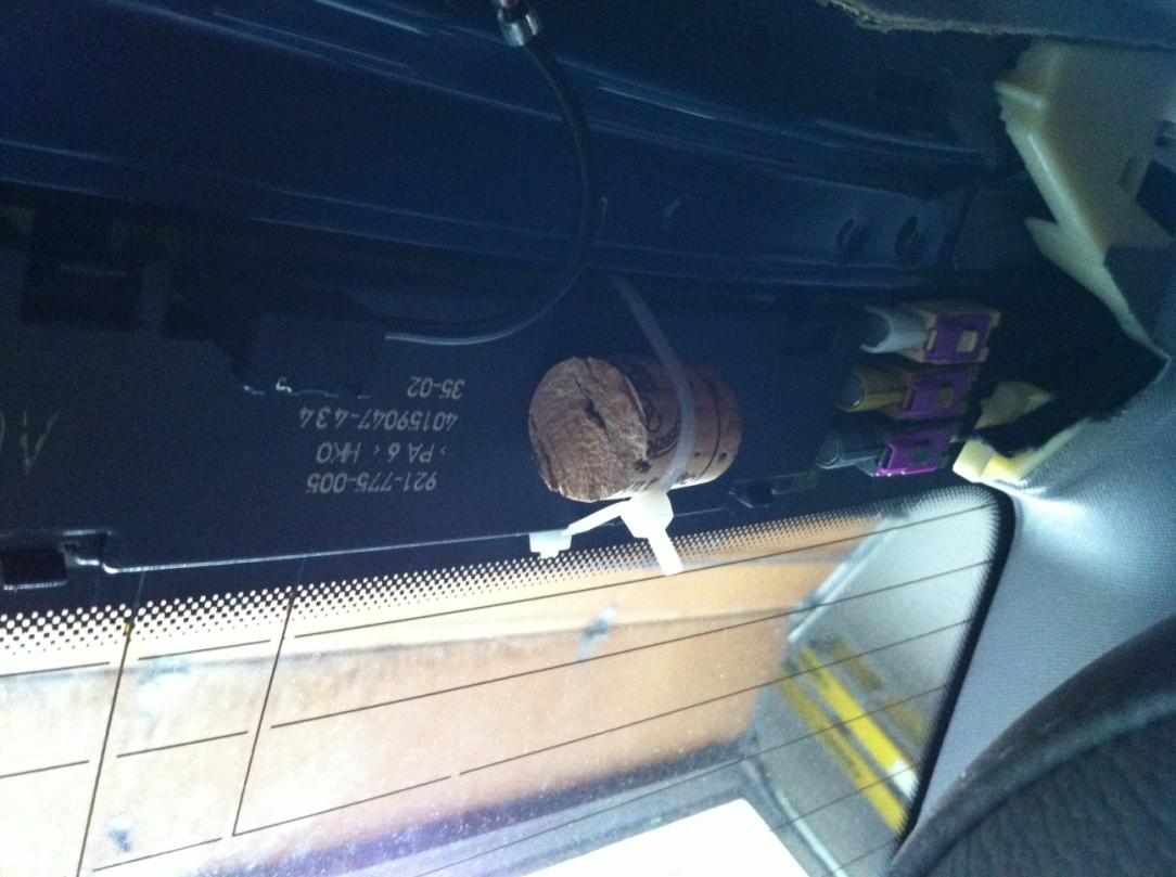

This was a motivating thread, I had the same issue. Few strong stations, autosearch found nothing across entire band. I took off the interior piece and looked. I did not see any cracks as others have said they found in extreme cases. Then I put on a weak station and with my thumb I pushed around different spots of my unit. Pressing right on the word "germany" I got instant great reception on my previously weak station. Auto search was finding multitude of stations like when car was new. the solution did not last, if I tapped around elsewhere the fix from simply pressing went away so I figured first pothole I hit would unfix it after a press. So I took a wire tie and a cork and rigged it so there is constant pressure on that spot. Seems to be working for now even if I press and tap around the unit. I am trying to attach a photo to this post, hope it works. Good luck.
