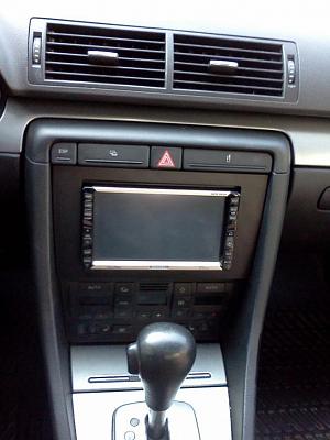

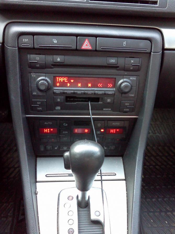

Here's my dash:
Eclipse AVN 6600
Attached Thumbnails Need a replacement radio (with USB) for my '04 A4-aud-b4-rad.jpg   Need a replacement radio (with USB) for my '04 A4-aud-eclipse.jpg
