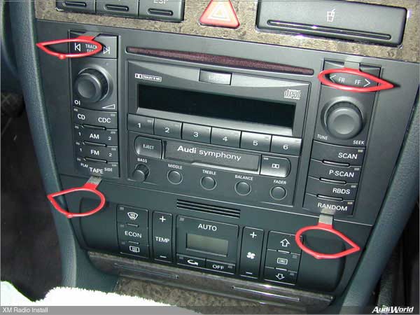

Hey I have a 96 Audi A4, I bought a line in converter, but I cant seem to figure out how to take the head unit off. Does anybody know how? Also I bought a set of JL Audio components could I wire those to the stock amp that is in the trunk. I believe I have the concert radio but I know the speakers are bose.

you need 2 sets of euro din removal tools, 4 total.. I get mine from here to do installs at work.
there will be four horizontal slots above and below the buttons on the side of the radio, stick the tools in with the notch towards center of the radio and pull out and back.
Attached Thumbnails New subs/headunit questions.-elec63_removaltools.jpg
