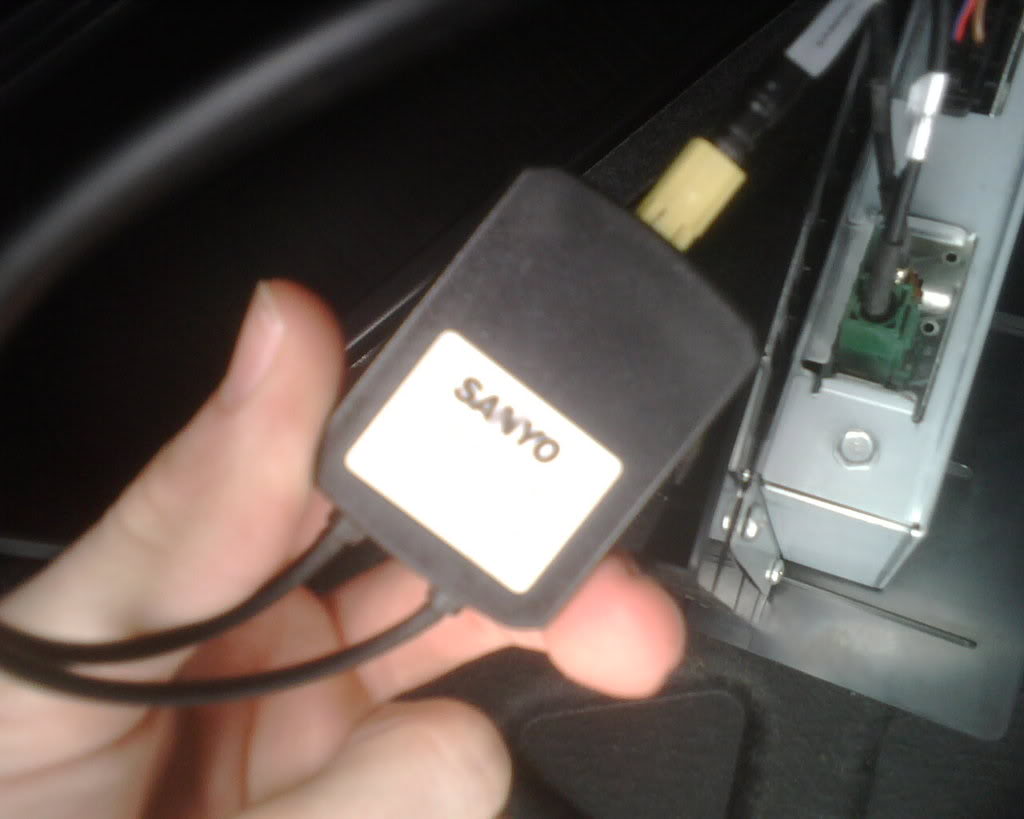

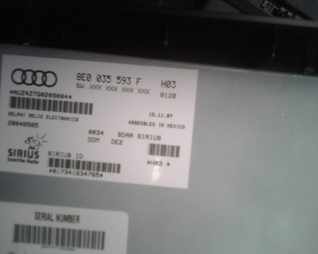

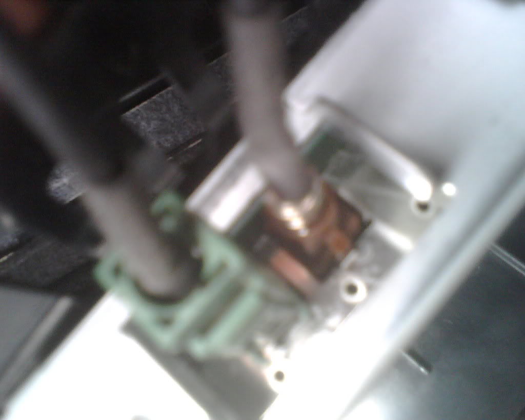

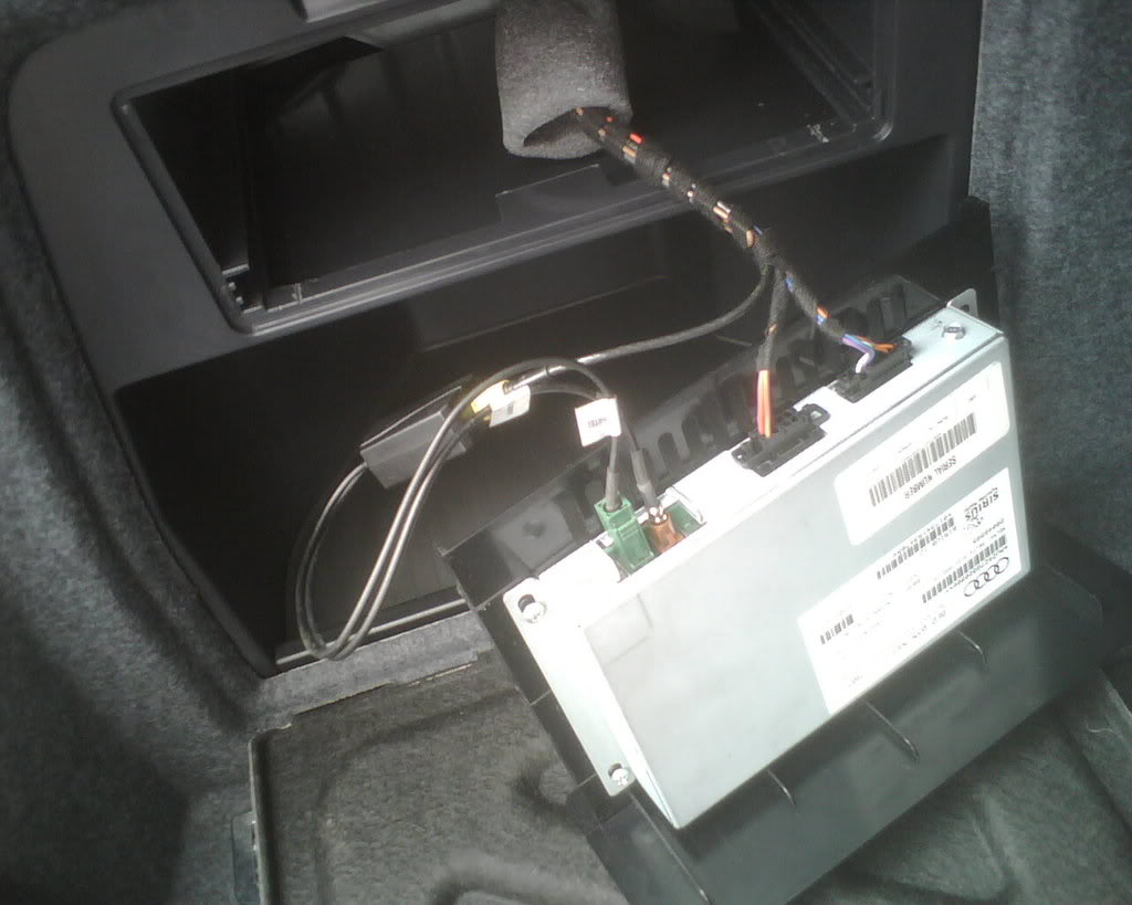

I have the perfect solution to your problem. And i just got it fixed today. Go to a very respectiable custom audio shop, that perferriable do high end cars such as Audi, Mercedes, BMW, Porsche, and such and ask them about a cross-over (Kinda like how you can go from 1 single home cable antenna to 2 antenna cross over box) and ask them about doing that for your module. It solved the problem i had, and if it were light outside right now is take pictures. But anyways, its basically the same thing as a home video cable antenna cross over module. And wa-lah, it will list the stations across the screen and not Antenna. haha. Your welcome folks.
Old Jan 13, 2008 | 03:43 PM
Kschroers1's Avatar
Joined: Jan 2008
Default RE: Symphony II and Sirius problem
Ok gents. Well i was able to go outside today and take pictures of the solution that i had mentioned. I had taken the car on the Audi side of the dealership that i work at before this solution was made. And the VW/Audi tech said he has only delt with this problem once before and Audi Tech Support had no answer for it and the customer was fed up and took the car after it had been there for several weeks while they were diaging the problem. But anyways. I couldn't live with the problem. The tech said now they are looking further into it since its now their second one. And i know they will since I myself am a tech on the GM side and my stepfather is the fixed operations director(basically runs everything but the sales dept.'s of the dealership). So, I had gone to the custom audio shop that we send our vehicles to that have the added bass and such installed to the vehicle then put them back on the lot. The shop deals with all the dealerships in my city, Mercedes, BMW, Lexus. . . Everyone! haha. But anyways, i brought the module to him yesterday and he laughed at the fact that Audi was using such an old design for the Antenna cable ports on my specific module. And yes the module does match my VIN number. But anyway's, he saw it, and said "oh perfect solution" went to the back, brought out a crossover type module that Mercedes Benz used to use to plug into their Sat. Modules they used. All he did was remove the keys, because they don't match the Audi keys on the module. They are securly fastened into the module and will not fall out, thats for sure. But anyways, i do plan on going to the Audi side of the company and showing them the solution i have and they can take that into account and maybe offer me some free Audi specs and replacement catalogs for my car. Haha always gotta stick it to the man. But hopefully these pictures help you guys out in trying to solve the aggravating problem.
