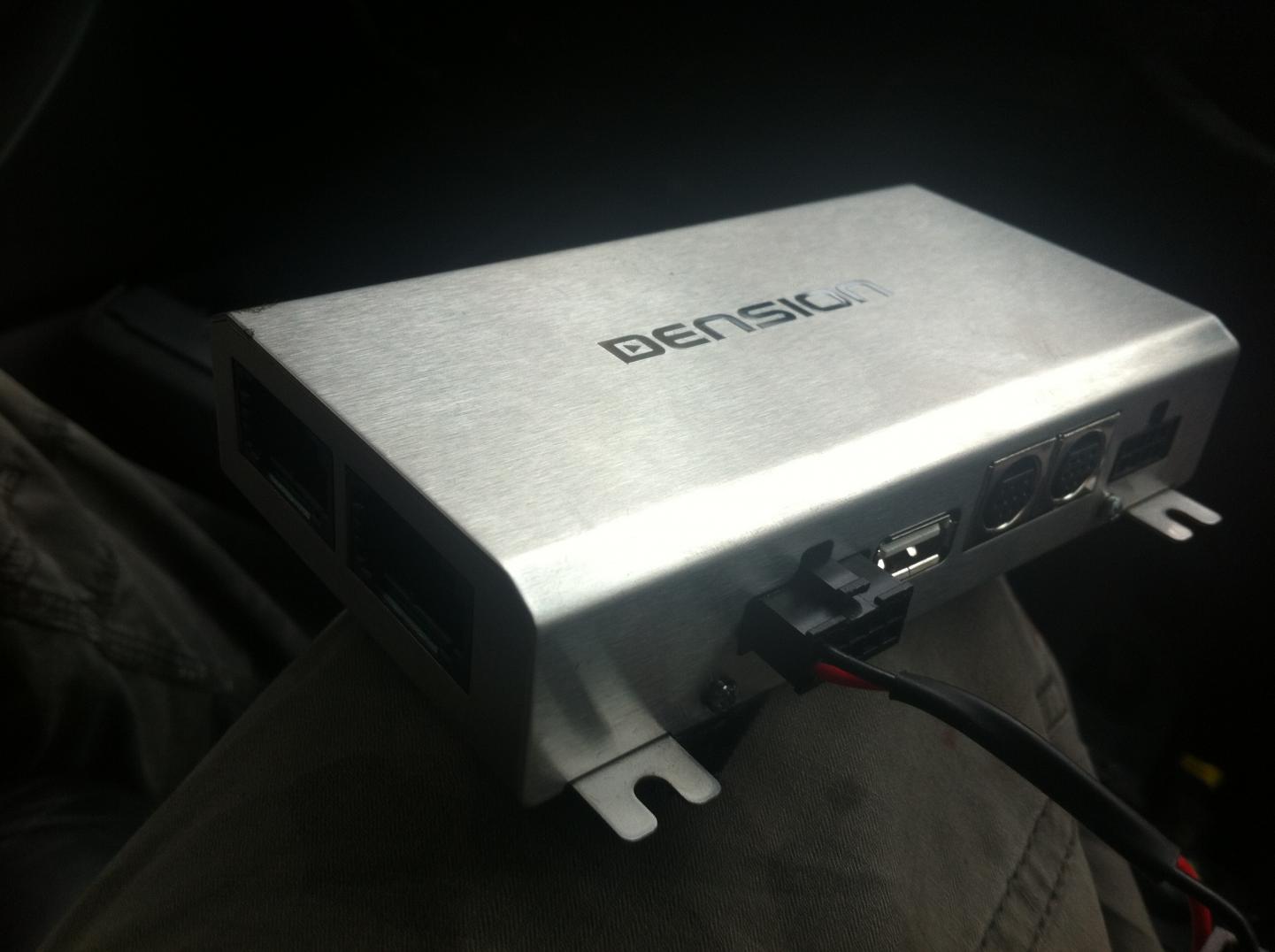

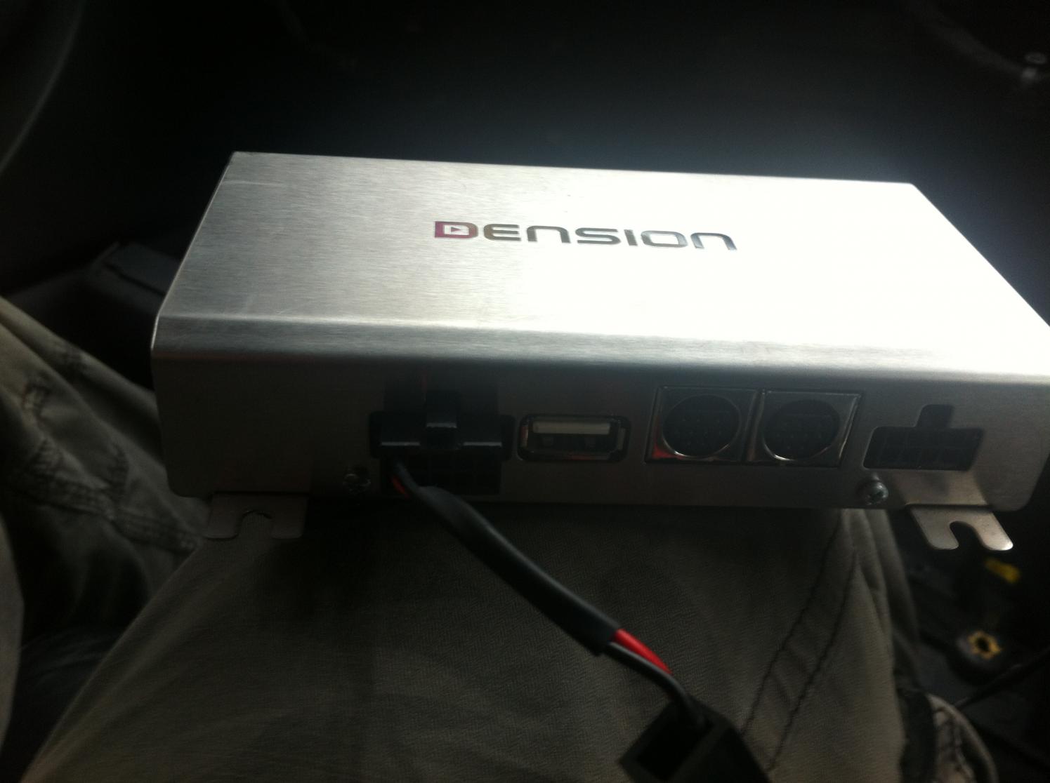

I have an Audi A8 and thought the CD changer didnt work. Upon taking the glovebox apart I found this Dension unit.
What is it? Am I able to use my iphone with it?

Was this unit connected to your mmi?
Does it say anything about a modelnr?
If I'm not all wrong this gives you the oportunity to connect iphone/ipod(the old plug), usb-stick and aux. I got the newer version, but mine is still called Gateway 500, and I believe thats what your unit also is called.
When connected you can use it via the cd-changer control, via CD #12 in the menu.
