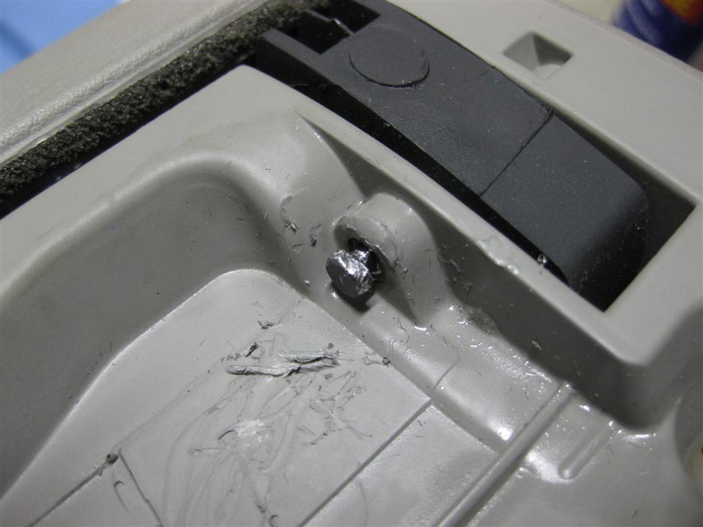

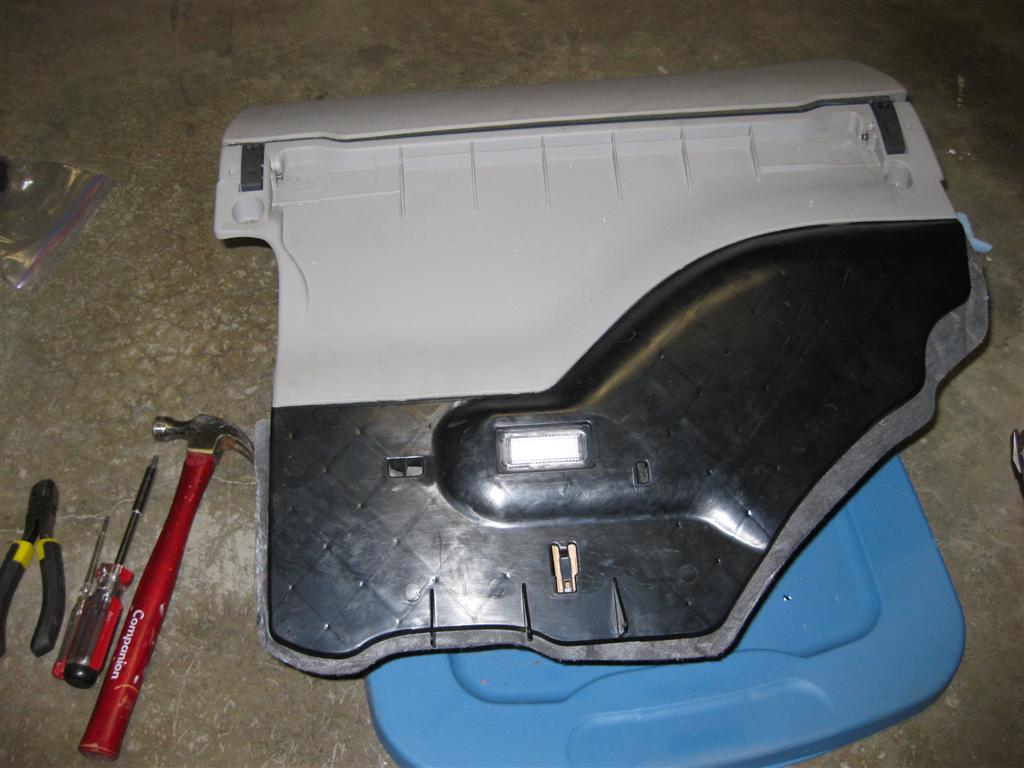

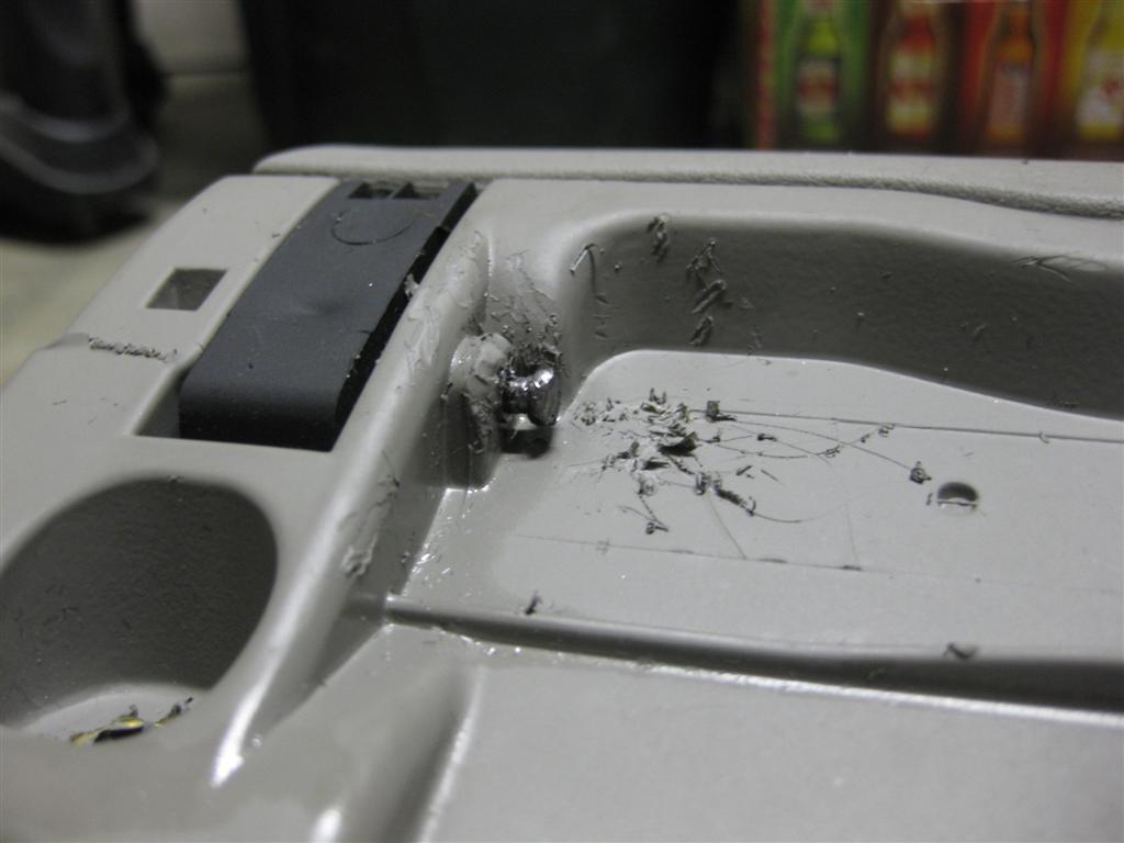

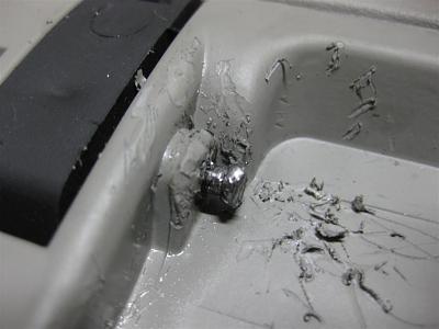

I am having the same glove box problem and I am trying to fix it. I am stuck at banging out the pins with some pliers and a hammer. How in the heck did you guys do this? I have a very hard time getting both pins out. I am currently trying to bang them out with a hammer, but they're slowly wearing down instead (but do come out VERY SLOWLY). I tried WD40, but this doesn't seem to make much of a difference. Am I missing something here? I want to fix my glove box, since I refuse to pay almost $500 for a new one. Thanks!

Here are some pics of my problem (also read my earlier post), see attached. Please advise.
