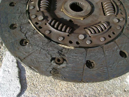

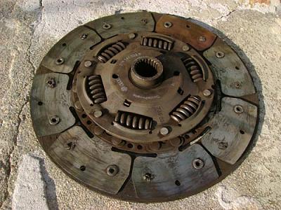

Here is the solution to my problem:
I finished pulling the transmission today and noticed that the slave cylinder had melted. When I removed the slave, it actually fell apart. Obviously, this would prevent the clutch from disengaging.
Since removing the transmission on a 4.2 S4 is so labor-intensive, I decided to check the clutch, pressure plate, and flywheel for wear/damage/etc. I had also noticed some large (like one square inch) chunks of clutch fiber in the bell housing. When I unbolted the pressure plate bolts, the clutch fiber completely fell apart on one side of the clutch and the other side showed heavy signs of wear as well as physical damage. Needless to say, I'll be replacing all of my clutch components. The flywheel actually looks like its in really good shape (and a new fw costs around $1000), so I plan on cleaning it up a bit with some steel wool.
After talking to some of the area dealer parts departments, it looks like a clutch, pressure plate and bolts, release bearing, and slave cylinder will cost just under $700. These can be found cheaper on sites like ECS Tuning, but I don't have the time to wait for shipping.
If anyone plans on doing a clutch or pulling the transmission on a B6/B7 S4, its very difficult, but not impossible with the proper tools. PM me if you have any questions or would like a .pdf of the bentley manuals instructions, which are very helpful.
