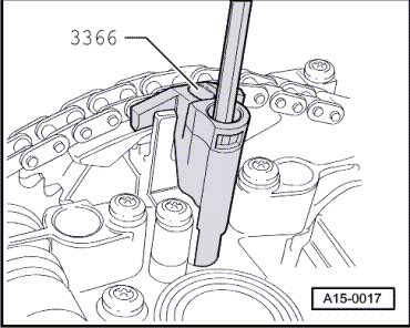

No, you would be correct on the cam tensioner seal. The tensioner on the driver's side cylinder head is right at the front where you say you're leak is coming from. You will also need new valve cover gaskets along with the cam tensioner seals. The good news is the cam seals are about $5 a piece, the bad news is they suck to change out. You need to fish out the seal from under the tensioner using a small 90* angle pic, you can only get the tensioner to come up so high because the chain holds it down to the head, its too much of a hassle to take off just for the seals. There is a tool you can buy from the dealer (or internet somewhere) that collapses the tensioner to give you more room that looks like this:

Good luck!
