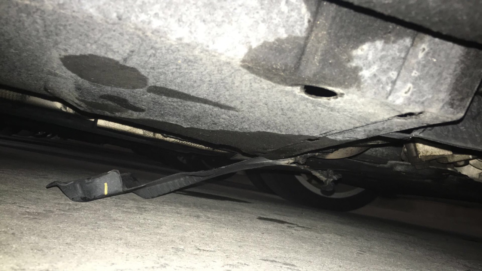

Major concern here...I was driving the other day and heard something dragging on the ground. When I looked under my car (Between front and back tire of passenger side) there was of course something hanging off my car. No idea what it is....was hoping you guys could tell me what it is and how to go about fixing it!

It's a plastic shield that probably covers the fuel lines that run down that side of the car. Easily replaced. Just jack it up and remove the rest to prevent it from dragging. The part number will be stamped onto it. You might find one online but unfortunately you may have to go to a stealer......er....dealer to get a replacement.
