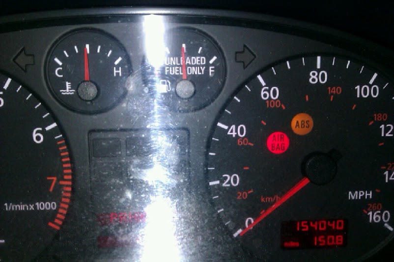

So, I have the usual lights Air bag ABS and Brake (flashing)
So, I bought (and installed) all new brake rotars and brake pads all around and the brake light is still on. Do I need to change my ABS control module for them both to go off? I heard they go bad. Plus mine got wet while unplugged. Suggestions?
It's a 1998 Audi A4 Quattro with triptonic.

Well the rotars and pads are already on. Do you think they were put on wrong?

No they weren't. Have a scan on the ABS system done. You may have a bad wheel speed sensor. Typically the ABS and brake lights together indicate a failed ABS controller but it could be a combination of sensor and pad failure. Get the scan done and post results and we can narrow it down.
