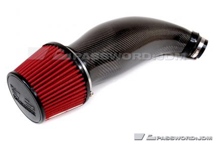

can i just add that the issue of hydrolock is very minimal. you would have to drive in a pond or lake of water that the water level is above both air intake tubes inside the air box. if the water level reaches the airbox lower half it will suck in air from the stock tube because of pressure.. it would take alot of vacuum to suck that much water up.
think of it this way, if you take a cai with cone filter and submerse the top part of the cone in water but not all of it, it may suck up drops at a time because air rushing in may bring some but it will not hydrolock unless the entire cone is submersed.
also even it it got colder air it wont help much after the engine bay warms up because the airbox will be heat soaked. maybe a couple degrees.
i have tried this mod and went back because the noise is quite annoying. to me it sounds like a NA car with a cai(you know that droning noise when WOT).
as seen in the photo, this is called whale ***** intake because the way it looks. its for hondas, but the idea would make sense here because of the turbo.
this way air is channeled toward the turbo intake. much like an exhaust should taper down near the end of the exhaust stream because the gasses cool down and become more dense. it occupies less space so it must taper down to keep velocity up.
