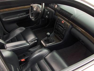

Anyway pictures are attached of how she looked when I first got her, next post will be about how tearing her apart went down.

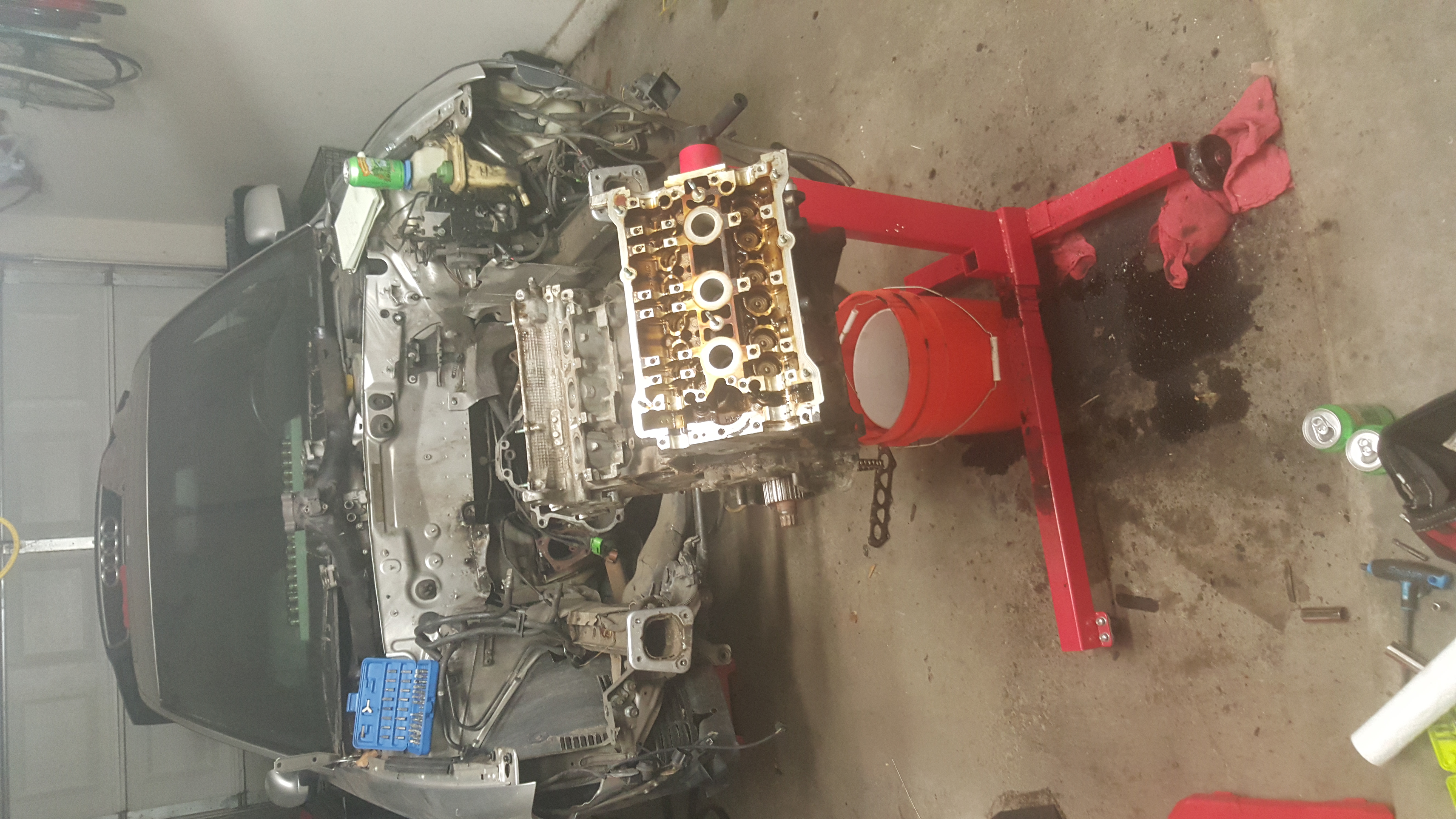

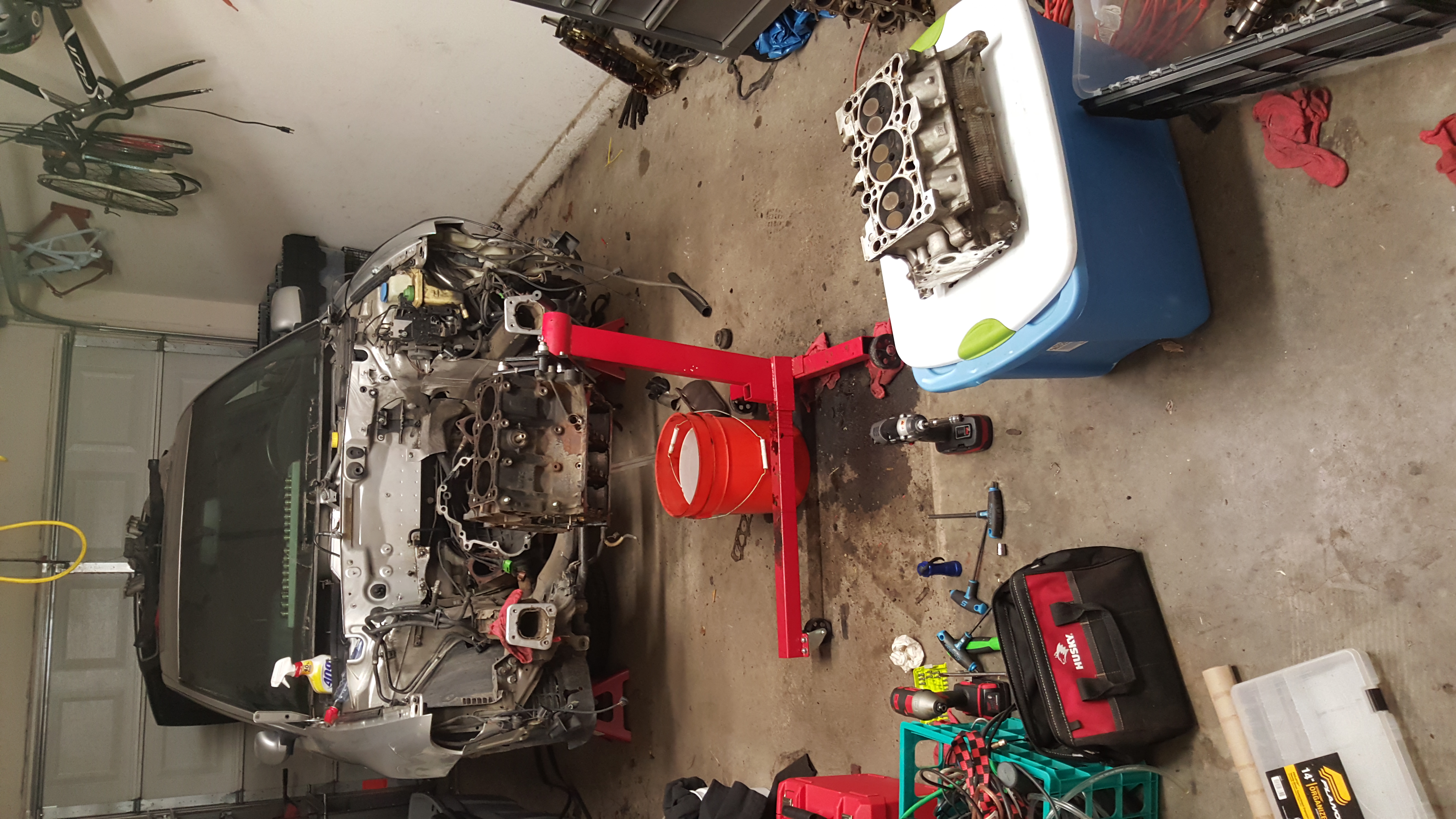

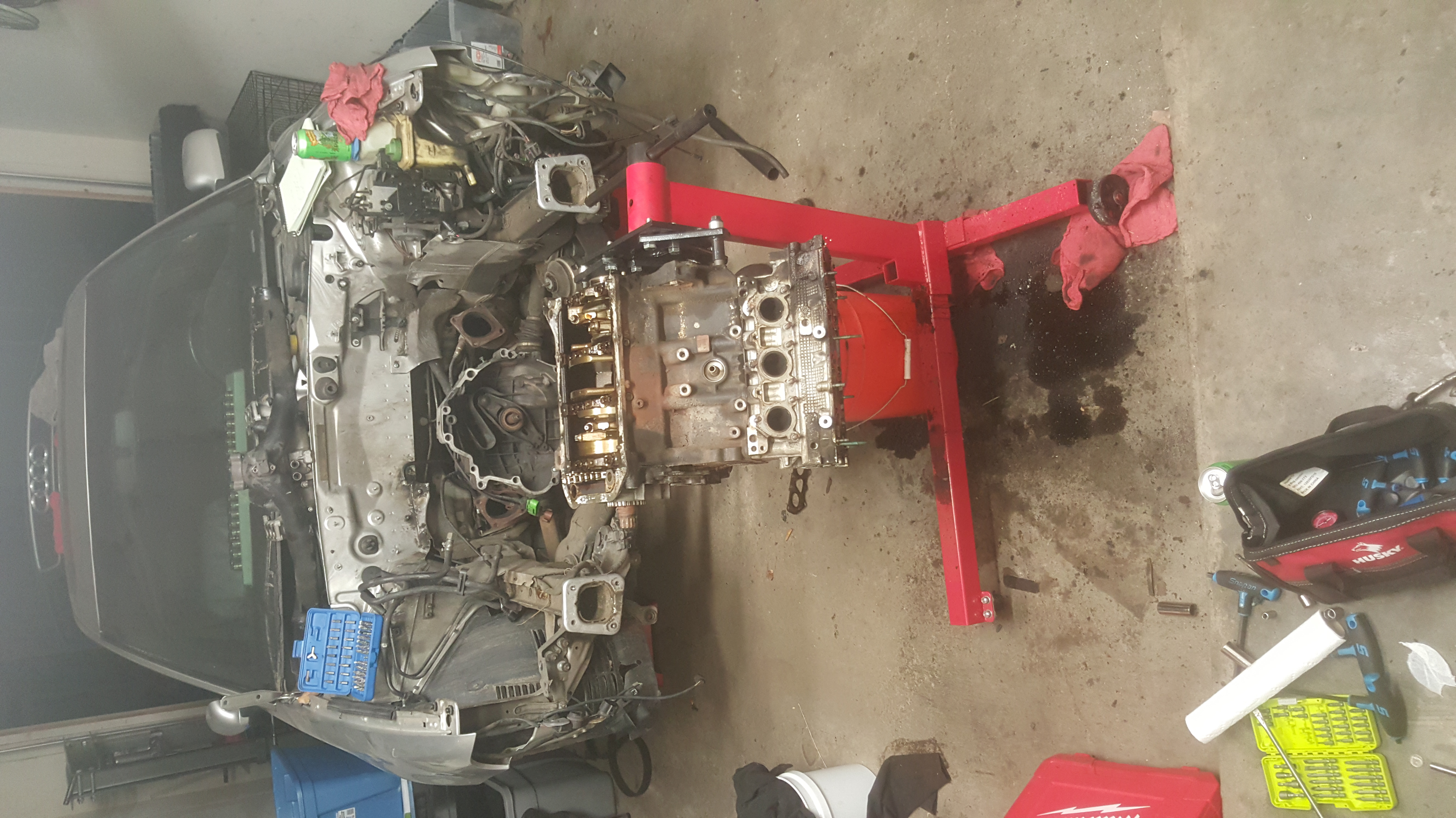

Default Teardown

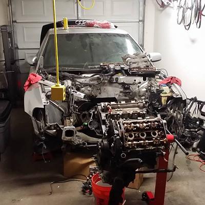

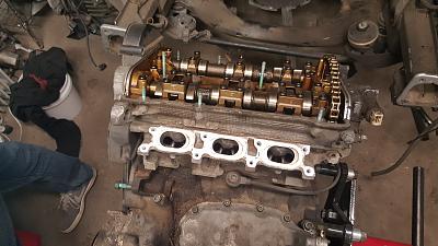

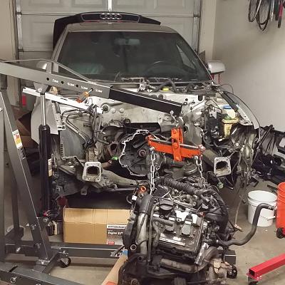

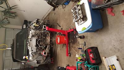

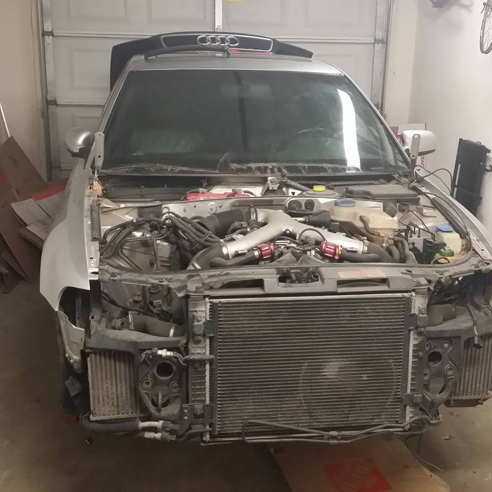

My buddy Tim and I began tearing down the car. See the attached photos for it's progress. Teardown went well, no big surprises. Once we got to the internals of the engine it is apparent that one of the heads is definitely warped from the head gasket blowing. That is no surprise though, the good news is that is it only slightly warped. Looks like maybe a few thou. The piston bores look nice still, dimensions are shockingly tight still and there looks to be enough of a groove pattern to get away with not honing it. Overall I have to say I am fairly shocked at the low amount of wear on this engine considering the amount of miles on it, especially miles with upgrades. Anyway take a look at the pictures, I would love to hear any feedback that you all might have. Hopefully you don't notice something bad that I may have missed.
Currently the block is out at my machine shop getting cleaned and decked, will be working on putting the block back together first, while I start on the heads.
I will continue to update as progress continues.
Attached Thumbnails 2001 B5 S4 Rebuild-10294512_10100172522870788_4228970015914113222_n.jpg   2001 B5 S4 Rebuild-944940_10100172522591348_8465290832434561277_n.jpg   2001 B5 S4 Rebuild-943998_10100172522646238_3214379038007340342_n.jpg   2001 B5 S4 Rebuild-20160227_222805.jpg   2001 B5 S4 Rebuild-20160227_195638.jpg
2001 B5 S4 Rebuild-20160227_220939.jpg   2001 B5 S4 Rebuild-20160302_205257.jpg   2001 B5 S4 Rebuild-20160316_222506_030.jpg
