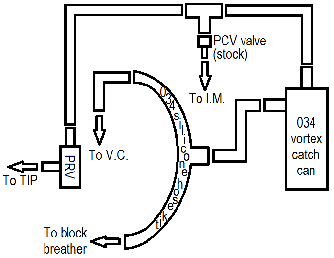

1) To start with, I never posted up the "schematic" of my super-duper PCV system which is basically a stock-upgraded PCV system with a catch can in the middle:

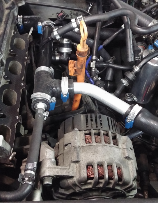

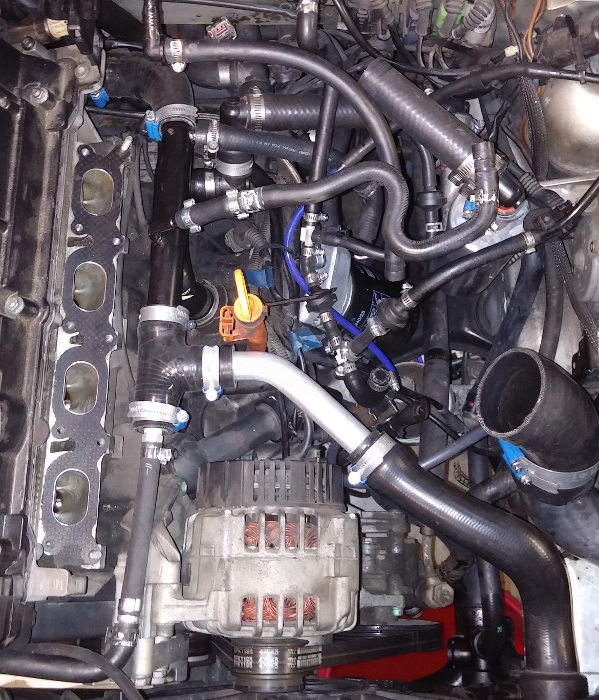

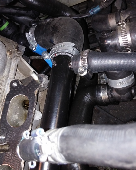

3) Also this past weekend I relocated the upper coolant pipe (which normally sits above the intake manifold) to below the intake manifold. The main reason for doing this is to avoid having to drain/lose coolant EVERY time I want to remove the intake manifold. So far I only have pictures of the coolant pipe relocation without the intake manifold re-installed... but I've driven maybe 25 miles on it so far (in 4 separate trips) and don't think anything is leaking.
It consists of a B6 (genuine Audi part) coolant flange, some silicone couplers, bunch of hose clamps, custom adapter for the turbo coolant feed line, 45-degree aluminum pipe, a cut-down upper coolant pipe, and a shortened coolant hose from coolant pipe to oil cooler.
