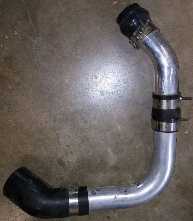

I don't remember exactly what angles off hand... the only hassle is that I don't have the parts in front of me
I think it went like this: intercooler --> 45 deg. silicone coupler --> 90 deg. pipe --> silicone hump hose coupler --> 45 deg. pipe --> coupler to throttle body (if using 2.5" piping and a stock throttle body, you would use a straight 2.5" coupler)

I was correct in my previous post regarding the angles.
For 2-inch piping, 2.5" intercooler outlet, and stock throttle body:
intercooler --> 2.5" to 2" 45-degree reducing silicone coupler --> 2" 90-degree pipe --> 2" silicone hump hose coupler --> 2" 45 degree pipe --> 2" to 2.5" straight reducing silicone coupler --> throttle body
For 2-inch piping, 2.5" intercooler outlet, stock throttle body, and 3" blow-through MAF housing:
intercooler --> 2.5" to 2" 45-degree reducing silicone coupler --> 2" 90-degree pipe --> 2" to 3" 45-degree reducing silicone coupler --> 3" VR6 MAF housing --> 3" to 2.5" straight reducing silicone coupler --> throttle body

RedA4B5 : I pulled out the cold-side intercooler piping finally this past weekend, and I have it in a convenient location but didn't yet have time to take any pictures. It looked like just what I described in Post #252
Will try to get that picture soon. Also I do plan on keeping the pipes and couplers from this, since I'm going to try to fabricate a new hot-side intercooler piping for my current setup (to replace the CX Racing hot-side piping).
I should note that at the end of the hump hose coupler used to be a straight pipe (actually had a nipple for DV relocation), then a 2" --> 2.5" silicone reducing coupler.
