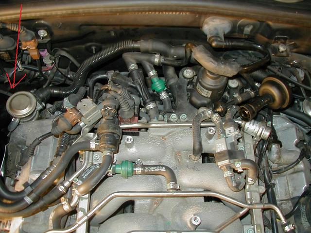

<a href="http://imgur.com/qvfLSbN"><img src="http
Wasnt sure what link to use but I hope at least one of them showed up. The small amount of smoke was coming from just under the part where I have the arrow pointing. You can see the jet suction pump in the center of the pic.
