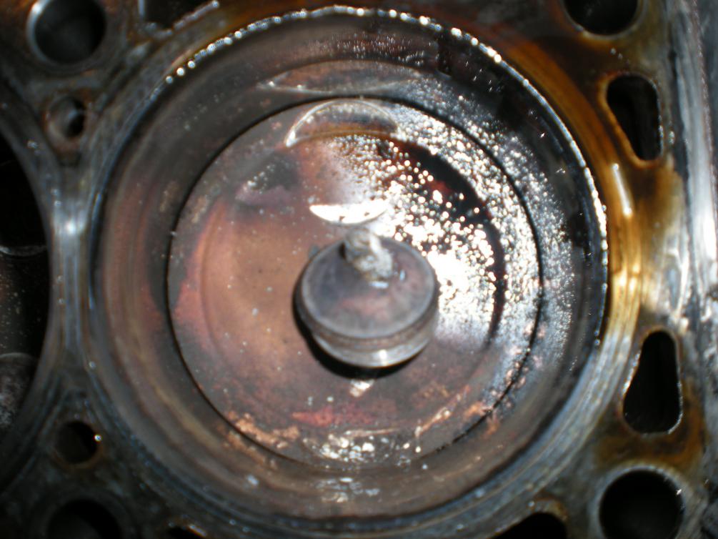

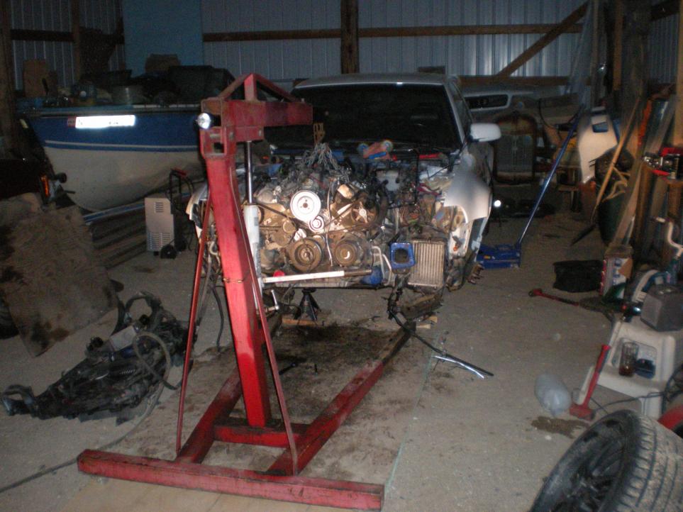

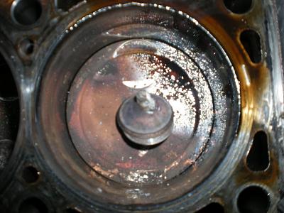

here is what my no start turned into. after trying to start it a few more times the motor seized. I haven't torn it apart yet but I'll update when I do. Into it 5 hours now. and yes thats a dirt floor.

I don't mean to say anything mean about your buddy but I'm just throwing it out there. I'm sure hes a great guy and totally trustworthy. I had that happen to me with my saab 900 a few years ago and what happened was I happened to notice my coolant temp almost pegged to the the hot side and I immediately pulled over and popped the hood to let all that heat out. I waited about 40 minutes until it cooled and drove gently the rest of the 5 miles to home. The next day I was checking it out and a coolant line had burst and drained my coolant and so very closely seized the motor (ran great after rebuilding the heads.
Moral of the story, maybe your water pump or some other cooling component failed while driving and your buddy didn't notice the hot temp gauge. The 2.7t when its warm only takes a few minutes without coolant to be dangerously hot.

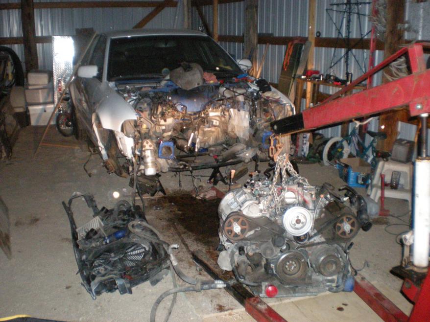

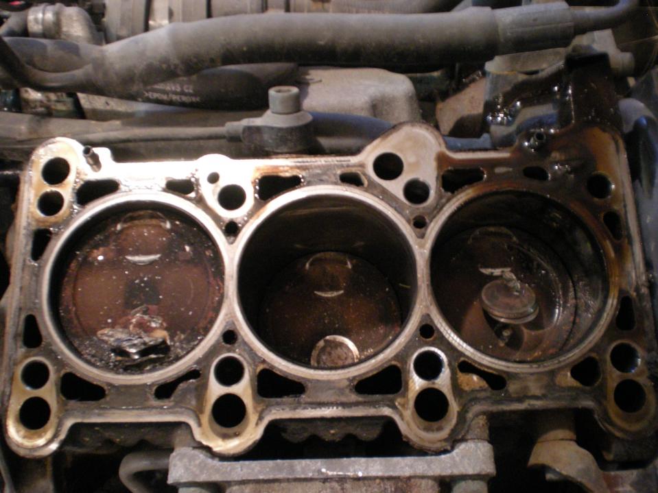

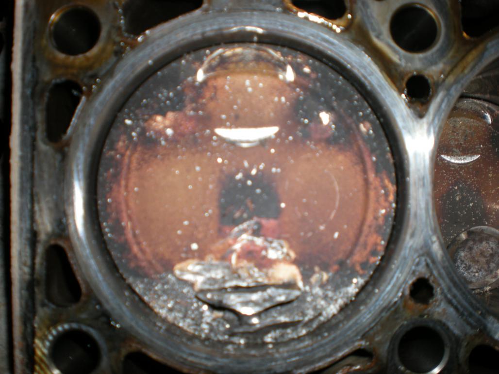

very possible! here are my wonderful findings! Gonna go 3.0l now!

Holy piston head batman!
Is everything on that block toast then?

pretty much! I may be able to use the block, gonna take it in and see in a few days.
