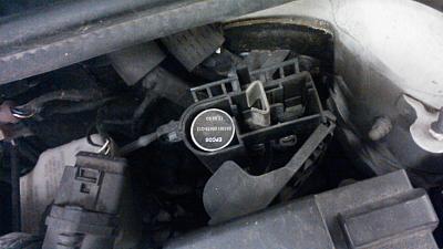

I'm thinking that this is still above the 12.6v of the battery, so it should be charging. Also take a look at the pictures, I'm a little troubled by the paperclip fuse that some jackhole installed. What is that wire for and what size of fuse is it supposed to have. Also, in picture number two, connected to the remote battery terminal in the engine bay is a capacitor looking device. What is that thing for? Sorry, I'm not a total car noob, just not used to working on German vehicles.

The battery sometimes drains at idle. When it falls to about 12.0, the idle RPM will increase until the battery hits 14.4.
That paperclip has to go. It's probably causing the computer to see 14.4 volts immediately after boosting idle. Maybe there's another one in the trunk.
