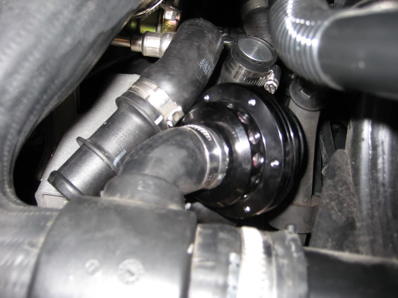

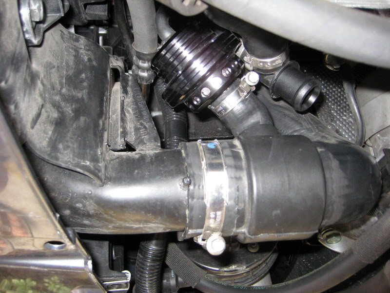

Im leaving for autozone now.... this is what my setup looks like...

I just got back from auto zone and got code--> P0172: running too rich
any suggestions?

IT's a vacuum leak then, why isn't that hose to the right of the 004 in the bottom picture (to the left of the 004 in the top pic) closed off? Did that originally go to the reservoir that you removed? 99% sure that there is your problem.

Default RE: **UPDATE**My BOV on B6 1.8T**Throwing codes like a ****
yes thats the hose to the res... How do you recommend closing it off? can I seal it off with electrical tape?
First of all, does any airflow go either in or out of the res? Where does that open hose go to? Are there any other hoses connected anywhere else to res, and are there any sensors built into the res (maybe similar to the MAP sensor in 2000+ B5s on the side mount intercooler). I really don't know much about that year, but if there is a similar air pressure or air flow sensor in the res, then you cannot simply disconnect it. And if there is no sensor in the ressystem (including hoses) and you are eliminating it, youstill do need to close off all the other hose that have flow through them.For that hose, i would either cap it off with a rubber cap and a hose clampif you can find a cap to fit well. Alternatively, remove that "T" and replace it with an elbow or even a straight coupler, if the hoses will reach.
yeah that hose should def. be plugged. large bolt and clamp woulddo it.dont give up on this yet. i can help you out when we get back to Tally, or i think khj677turbo is in Tampa
