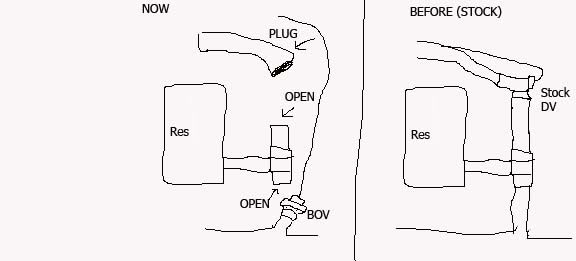

Draw up a sketch of those hoses (using paint or someother basic program) so we can see what hose it is that has the whole.. there might be an easier alternative to plugging the whole

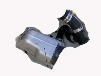

both ends of this house at the T are just sitting there open doing nothing.
Heres is a res that been pulled from a car, you can see a hole in the top... I don't know if mine has that hole and/or thats causing a problem too.
Old Dec 22, 2007 | 08:46 PM

well, try plugging the bottom of the res t-fitting (the one by the bov in your digram, and connecting it at the top... , that way everything is either connected, or plugged off

ORIGINAL: AUDI05
I could plug both ends of the "T" because both are open.
But What would I connect the top too?
Old Dec 22, 2007 | 09:47 PM

here's what im sayin

ORIGINAL: Lazer Viking
Just now saw this thread.... THANK YOU for that pic above
Also, dont go blaming something until you know exactly what is the cause behind something. The air is probably leaking out of the res and throwing the code, the pic above should correct that since the res is still in place.
