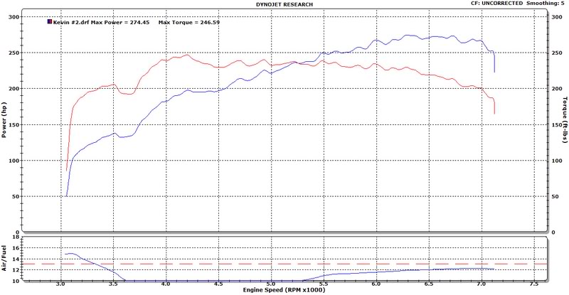

I found one. Its better than what i usually see. But it does go beyond rich at peak boost.
Now claims 320whp with w/m. Thats still less than a regular gt28rs expecially on pump. The tq on these is just to low compared to a traditional .64 t25 housing. Still 500rpms more lag also over a .64 gt2871r. Im not saying their bad, just not on par with the traditonal turbos. The tuning has gotten better so that helps.
