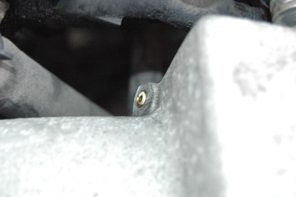

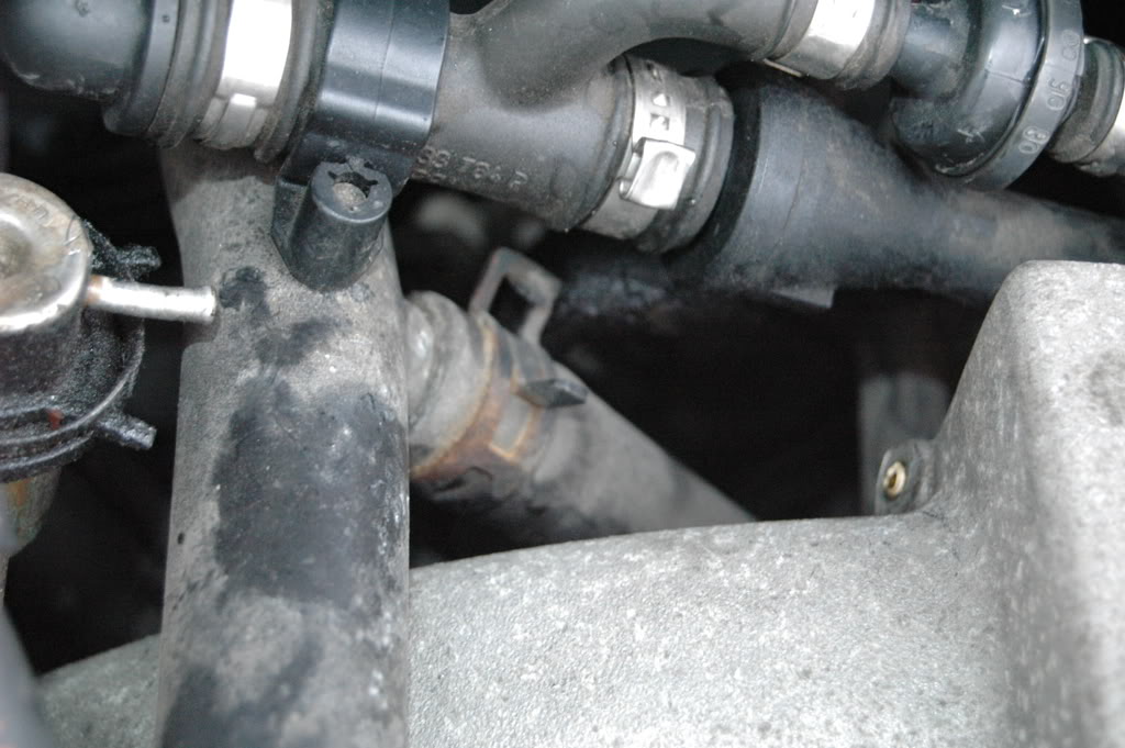

There it is. I attached a vacuum hose to the fpr then gave it enough slack so it could rest snug on whats left of the nipple.. I drove about 30 miles today and had no problems. So it looks like I'll be looking for a welder or new used manifold. thanks for your help!

you need to have a vac line to the fpr for fueling. you will be fine if you just tap into another vac source until you are able to get that fixed and the hole blocked off in some manner
