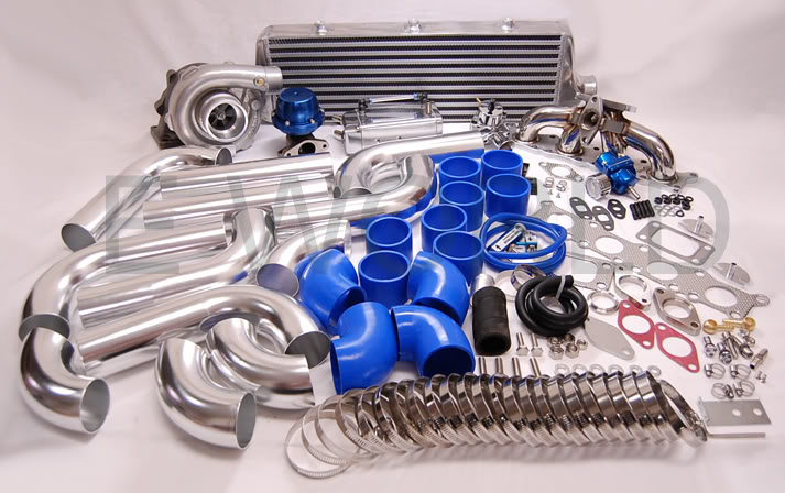

here is another set up, its probably cheap crap but maybe not
http://cgi.ebay.com/ebaymotors/ws/eB...43437&rd=1
as for me i think i'll end up with a KO3S, if i can find one

lol where to start...
turbo is probly glued together. uses cheap clamps instead of t-clamps. silicon connectors look like complete *** and really cheap. looks like there is a section of marine exhaust hosing in there lol. exhaust manifold will probly crack from boost out of a k03. never even seen a flange with 2 bolts. fmic is low density. piping looks really thin and cheap. there's some nice hoses and tial wg tho[8D]

The 2 flange is a tial 38mm wastegate flange. I think its funny they throw in a oil cooler and sandwich plate. Those and the piping might actually worth something
