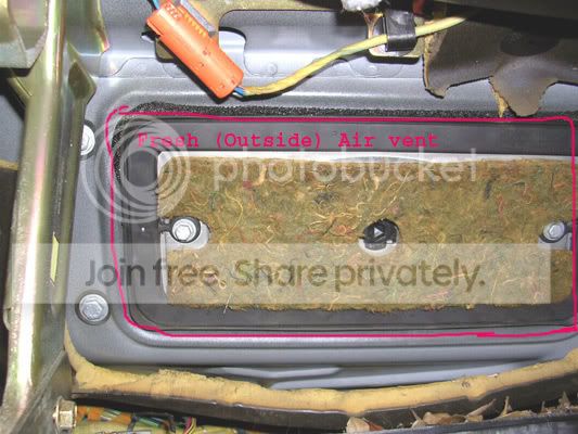

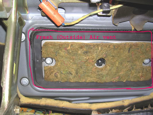

The two likely places for water ingress in relation to the footwell (only the passenger side?) are:
a) the fresh air exchange flap - which you can locate if you remove the glove box
(that would mean your firewall drain - there's only one, unlike other years - is clogged and you accumulate lots of water in there when it rains, sipping inside through the flap opening
b) through the footwell air vents - if you run the AC a lot (i have no idea where you live), as condensation that doesn't drain and is push through the air vents by the blower.
Since you didn't mention that your feet got ever wet while driving, then probably it is A
I have the exchange flap on mine shut all the time, no "fresh air" exchange, as I unplugged the vacuum hose. Also, I clean the firewall area from debris quite often and maintain the drain clear - you can even cut the rubber "nipples" so sticks or foliage would NOT get trapped in there and clog it.
I hope you find the source of your wet mishap.

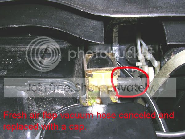

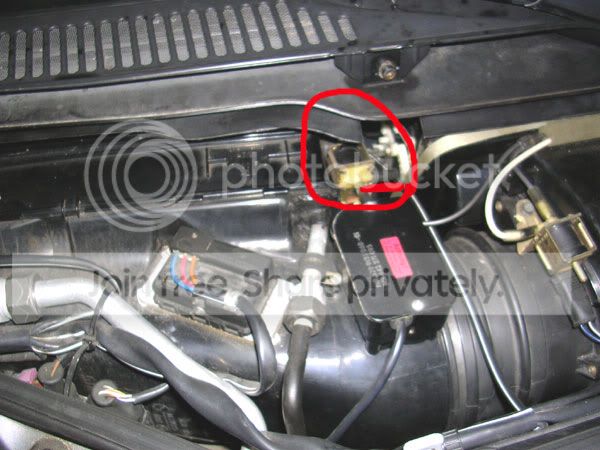

If you remove the cowl, you should be able to locate it easily. Follow the hose and you'll find the connecting spot, although you'll have to remove the three-bolt cover on the evaporator box.
I removed the vacuum hose entirely and capped the feeding exit on the valve- see the pics.
And here you have a chance to see the vacuum hose:
I sincerely hope that the flap is your problem, or else you need to become a Watson.

so I got around to testing the fresh air vent and sure enough it was leaking. Pulled the vacuum line like you said and the hose over it again and still leaked. Picked up some silicon and sealed it and so far so good.parked it outside going to closely monitor it. Will up date with my results. Thank you so much for your help!!!
