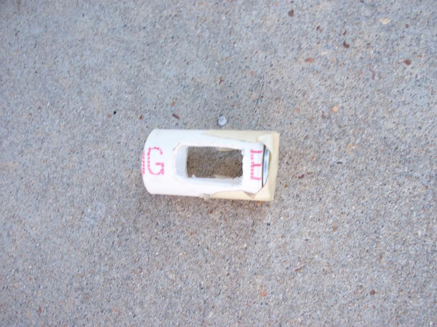

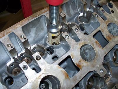

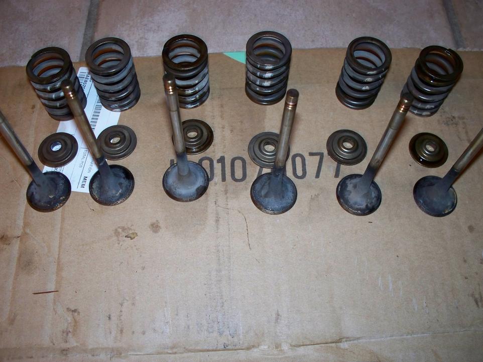

I purchased my '02 ($2K) in July (108K) thinking it was just a 'jumped' timing belt. It was a locked up intake camshaft due to poor oil maintenance - clogged oil ports. I made my own compressor spring jig out of PVC tube and used a 8" clamp. It took the whole day to replace 30 valve seals ($1 ea) but i saved $300 plus parts. Replaced only 3 intake and 2 exhaust valves. Mechanic told me that the lifters didn't need to be replaced although audi recommends it...I hope the mechanic is correct.

Check out the homemade PVC jig and clamp.

I like the creativity. How did you handle the valve keepers though?

It was almost like performing surgery. I used a small flat head screwdriver (4") and magnetized the tip with a magnetic. The key is aligning the PCV openings in the right place to get access to proper installation. It got easier after the 2nd and 3rd ones...
I used 2 different PVC sizes - one for intake side and other for exhaust side. The taped washer was due to the smaller OD on the clamp. Overall length on each PVC is 2.5" - took about 10 minutes to make with drill bit and a sharp knife. Be careful with the knife, i had a minor cut to the finger. . .
