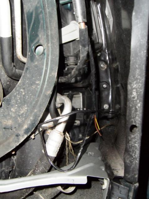

First set of cut wires I found was inside the front passenger side fender, near the front bumper mount screws on the passenger side. There is a package wire cluster that has two wire pairs. One pair is a yellow and brown wire; the other is two black wires. Maybe brake pad sensor and homelink receiver wires?

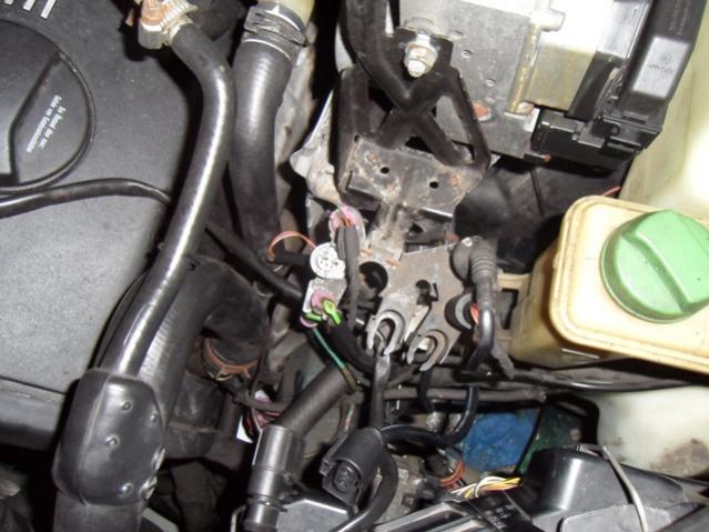

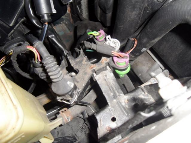

Second issue is a cluster of wires, sensor connections under the plastic cover near the power steering fluid reservoir. There's one connector unconnected (white facing up in picture), another purple on top/green on bottom also unconnected, and a black one with what you may call an accordian elbow (two black wires exiting). Again hoping that these are non-essential wires, but want to know how to fix otherwise.

First what motor do you have? I have a 2001 A6 4.2 and I have also have had a 2000 v6 passat and the connectors were almost the same in the same location. You are missing the two large oval connectors for the A/C cooling fans that should be mounted one in front and one in back of the radiator and condenser. The green connector is for the A/C clutch. There should be one for the hood latch sensor. one for a sensor that is mounted in front of the condenser that is for the out side air temp. one for the fan switch. I have attached a pic of what mine looks like

Thanks for the reply and photo. I do have one of the large oval ones loose from the carrier. It was not connected when I got the car, when connected the AC fan typically comes on even when the engine is cold. Not sure where the other large oval wires are or other missing wires. I was hoping I could do this myself, but my Bentley manual isn't very helpful, so I appreciate any help I can find on this forum. I will probably end up taking to a local indy audi mechanic to figure out how much it will cost to put this thing back together correctly and whether it is even worth fixing.

there is also a control module mounted in the bumper so if it is kicking on when its cold it is bad and i know they run around $200. if you are in the chicago area I could also give u a hand on fixing it. have you checked if your a/c compressor kicks on? i was just looking at a wiring dig for your motor and i think you will only have one connector. do you have one or two electric fans? Do you get your outside temp on your cluster?

Thanks for the reply. Where in the bumper is the control module located? I thought I found the coolant fan control module, but it wasn't in the bumper, it was below the ABS module. I grew up and lived in the Chicago area for my first 30 years, but am now in upstate NY. I still appreciate the offer to lend me a hand. I haven't checked the AC compressor. There is only one electric fan, it's obviously working since it comes on, but control for it is bad. My cluster does show an outside temp, but I am not sure it is accurate. I also was looking at parts diagrams, and I believe there is supposed to be an air temp sensor mounted in front of the radiator on the PS metal loop there. I don't know if this is the outside air temp sensor that connects to the cluster, but am thinking this might be one of the missing/cut wire connections. I also believe that the hood latch sensor is missing, this may be one of the other missing/cut wire connections. Still trying to figure out the third missing/cut wire connections. Getting a little frustrated, these wires are hard to track. If you have any other thoughts, please let me know.
