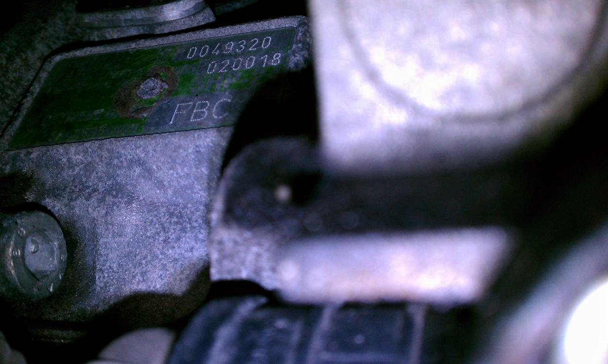

Using reverse a few months back - on an incline, caused 4 quick loud metallic noises from the trans. Since that time (using reverse gingerly)has yielded no problems until recently. Now, in AM after start, reverse is weak when car cold. This past week, it had disappeared entirely for a few minutes (until fluid warmed?). Forward gears work flawlessly, no codes.
Obviously there is a problem. My local trusted shop says the "reverse drum is broken". They are usually pretty good on the diagnostics but they don't want to do the job. Say they don't do enough of them.

I attached the trans tag w/model info.

Attached Thumbnails 2001 4.2 - Reverse disappearing....quick strategy check-imag0026.jpg
