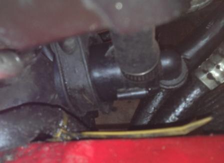

Default 2.8 Aux. Water Pump
My 2.8 has an auxiliary water pump, or at least something that looks just like the auxiliary water pump listed for it on partsgeek. I know because I just had to replace one of the crazy German dogleg, offset, two-different-diameters-in-the-same-hose water lines that are attached to it. I have no idea what it does, but it's there.

Link or pics? Maybe we can clarify what you're seeing.

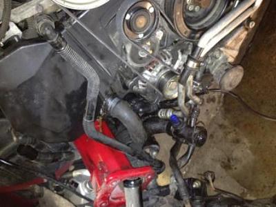

Default Aux Water Pump
Here are some shots of what looks like an auxiliary water pump. You caught me at a good time since I just did the timing belt and cam/crank seals yesterday and I haven't put the front of the car back on yet.

I think you're referring to the secondary air pump. That's an emissions device for cold-start. Nothing to do with coolant.

From: Grand Haven, MI
I might believe you, but when I replaced the lower hose that attaches to this mystery pump, a very large coolant leak stopped. I'm not saying that couldn't have been a coincidence, but I just crawled under the car again and that same hose connects to a steel line that runs across the front of the oil pan area and then sweeps upward, connecting through another piece of rubber hose to the coolant reservoir. It's too bad it's not actually an air pump, because an air leak of similar proportions to my coolant leak would have been far easier to ignore for a little while.
Unfortunately, the fact that it's a coolant pump still doesn't explain its reason for existing. I know there are plenty of other vehicles out there that are perfectly happy with just one water pump.
