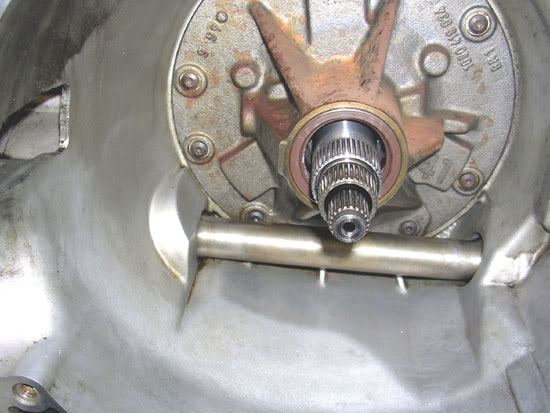

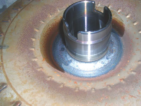

Currently I'm still waiting on some parts, I can't start assembly without: main bearings and the rings set. I also just ordered today a Torque converter seal from a ZF reseller (I just don't get this whole "intermediate man" crap since the "warehouse" is located right here in Illinois - Vernon Hills; I guess it probably is too difficult or waste of money/personnel to have one or two people that can take care of and fulfill individual sales/orders). Since the engine bay is presently gutted, I might as well take advantage now and replace that seal. I hear that in time they become "mushy" when heated, even if they don't show signs of leaking when cold.

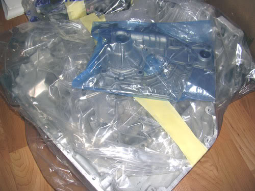

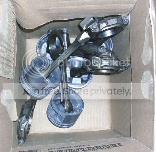

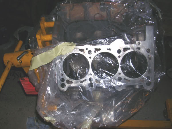

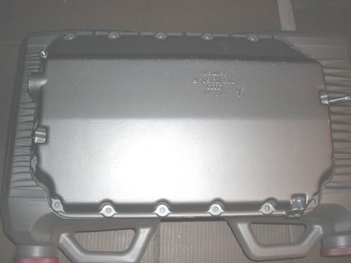

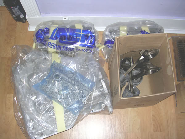

However, I got the parts back from the machine shop: heads, block, both sections of the oil pan, pistons. I already painted the oil pan's lower section, although is just aluminum for crying out loud; though it will make it look clean at least for a while...
The whole deal wasn't that bad: $ 257, which included a valve job (new seals and exhaust valves resurfacing/grinding - I think mainly the shoulders) and new freeze plugs.
I need to clean the piston's ring grooves before the ring set arrives, and then start putting them together. Thinking in retrospect, I should have left the crankshaft on and not clean the block. The cleaning process peeled off/dissolved the paint on it. Also, I had to order new main bearing cap bolts. Together with the connecting rod cap bolts ammounted for another $ 100.

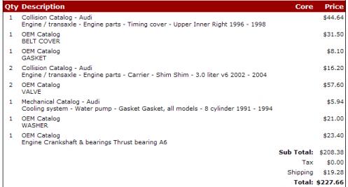

(from genuinevwaudiparts)
Dealer prices:
main bearing bolts (8) = $ 126 - $ 15.75/bolt...
connecting rod cap bolts (12) = $ 189 - $ 15.75/bolt...

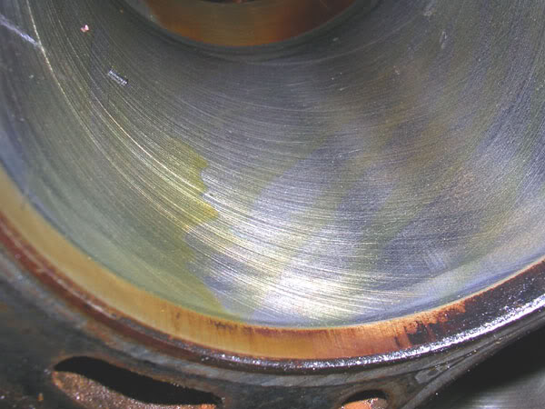

Don't remember if I attached this one or not, but the cylinders were looking still excellent @ 167,000 miles...
