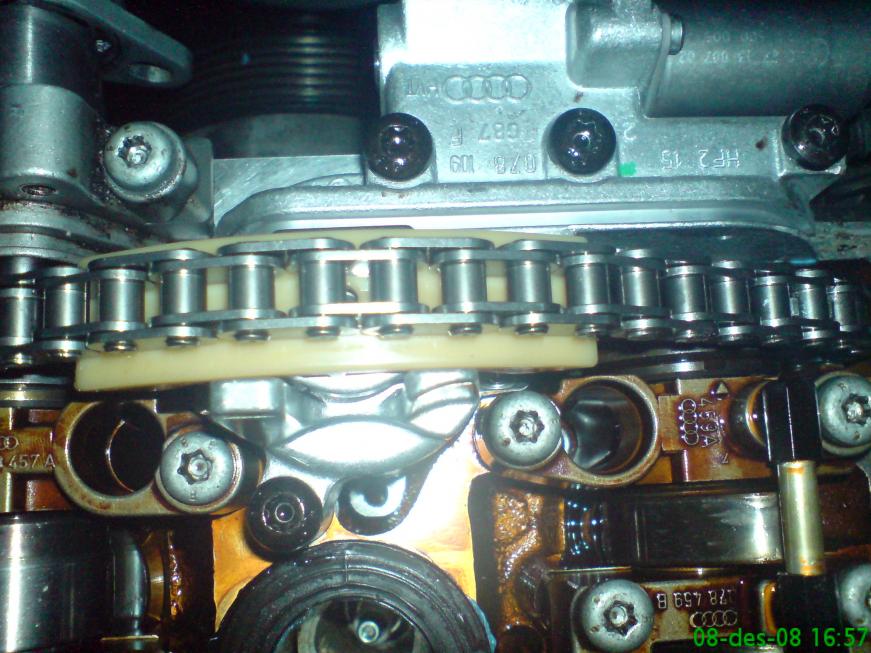

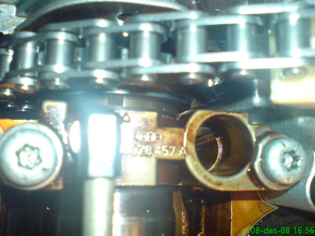

well.. i put in a brand new tensioner to day and one cam is still a little off..then the other new tensioner is probably ok then.

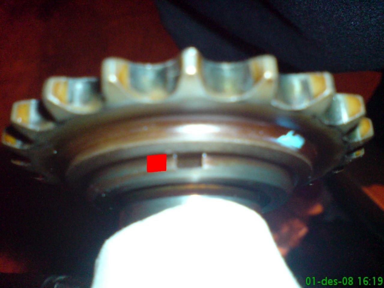

the onely thing that has to be the problem is the camchaft. if i got this right the mark should line up to where the chainroller should be,like the red mark. see foto nr 3.
i will get a brand new later this week. that should fix the problem..
correct me if i do this wrong.!
i put the intake cam at mark,install the tensioner with the exhaust cam and tighten the bolts for the cam and for the tensioner. then i remove the tensioner tool and the exhaust cam will move and the marks will line up. mine dont go all the way..
if you see the fotos you should see that the intake cam is lined up and the exhaust misses by a little.

Marks might not exactly line up with a roller...
When I did my cam chain tensioner seals and timing belt, I installed the tensioner first with the depression tool inserted. Then I installed the cams and the chain. It is okay if the cam rotates a bit as long as your chain doesn't jump a tooth. (Highly unlikely)

You have to bolt down and torque everything then turn the motor over by hand a full rotation before checking the timing marks. As long as you have the 16 teeth between the timing marks they will line up no matter what. If you leave everything loose there is no way they will line up.

As long as there is 16 links between the marks it fine, you should be good to go.
However if you get misfires on that bank after putting it all back together then you are still one tooth off.

i start to wonder.... well, the foto from the bentley manual i showing that i should start with chainlink nr one at the left side of the mark on the exhaust cam,and end it with link nr 16 right above the mark on the intake cam. i have done that with 16 links. but if i connect wagcom prog and watches the measuring blocks i get 9-13,5 BTDC at cyl.6.
i also think its strange. the two other cylinders is not showing so mutch of.
i have counted the tooths on the cam and its 21. 360 degrees/21= 17.14.
one chain link is 17,14 so if i had missed one tooth i should get 17.1 and not 9-13,5...right?
