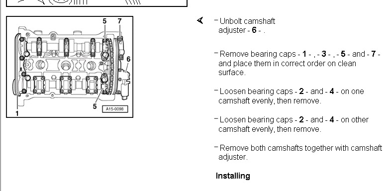

the bentley says that the caps on the camshaft from the tensioner out should be 4-3-2 like in this picture:
they wrote 4-3-2 really really small so its hard to see so i made a zoomed one
and this is mine
so as u see mine goes 2-3-4 instead of 4-3-2 my question is is it normal?

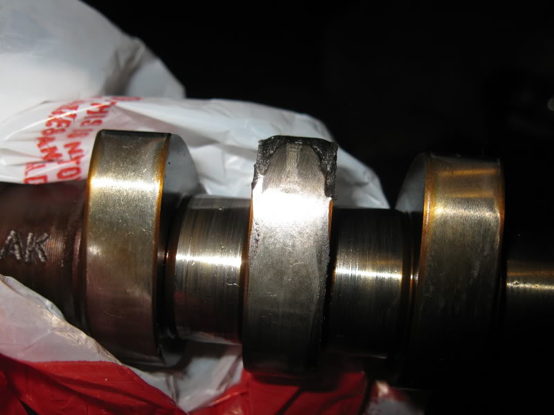

i had the cam tensioner gasket and valve gaskets done so i know they took all this apart and put it back together so could they have mixed the locations of 2 and 4 and as a result my camshaft and lifters got all screwed on those locations?(the lifter on 2 actually had a hole in it and the camshaft lobe was torn apart like crazy... ill get some pics of it when i get back from school)

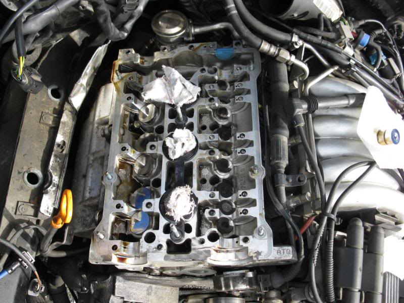

checkout how clean it is
and this is mine

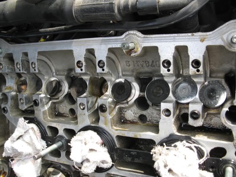

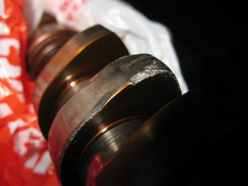

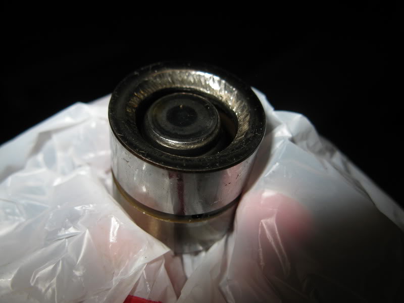

sooo here is number 2 on the camshaft

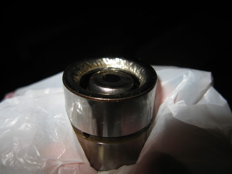

and this is the lifter (notice is has a freaking HOLE in it lol)

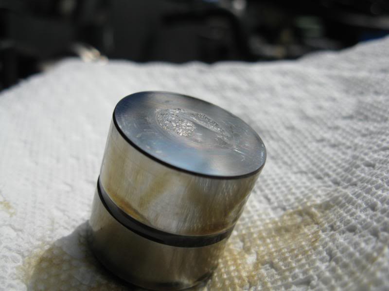

this is the middle lifter on number 3
and the middle one on 4 looks the same...
but overall it looks pretty clean to me
what and how should i clean in there?

By looking in the Bentley illustration, both bearing caps # 4 (regardless of being "single file" or "double file") are on the tensioner side.
In your photo you labeled them according to the number on the bearing caps (I can see them), so either your shop screwed up the bearing caps order when reinstalling (flipping # 2s with # 4s), or Bentley is wrong - I highly doubt that as my C4 illustrations are accurate.
Your engine is pretty clean. If it would have had sludge build-up, you'd have found it all over the heads.
I'm going on a limb and say that the lobe was screwed up by either the lifter which went out of normal position, or due to the wrong bearing cap it got oil starved. I mean you can see it is chipped... wow.
Your valves are looking extremely clean, so probably pulling the heads out would be a waste of time and messing up with the timing chain.

Wow, that sucks if it was the improper cap location that caused the failure. If they just replaced the tensioner seals and not the tensioner itself, there's no need to remove the caps or the cam. It's possible your shop didn't know this. I'd ask them if they took the caps off. If they did, ask for a partial or full refund.
